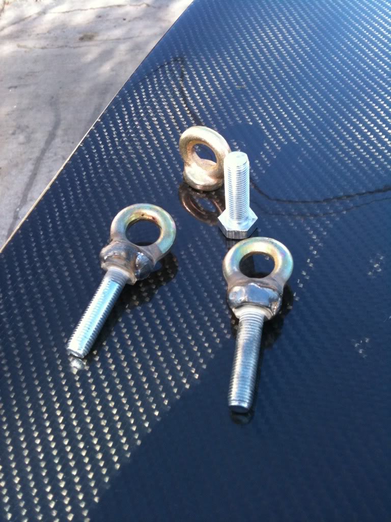

Late update: I sawed the top of an eye bolt and welded it onto a M 10x1.25 bolt I purchased at home-depot for $2.49. I ended up using the stock seat mounting points on the floor.

^ so awesome! win!
-J

Originally Posted by JasonZ-YA
^ so awesome! win!
-J
I did the same exact thing 2 weeks ago for the floor mounts on my Crow harnesses, using this thread for a reference.
Thanks for the idea Jason!
