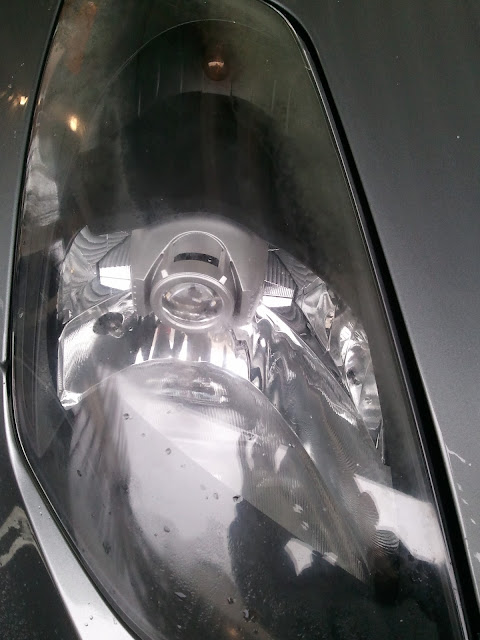

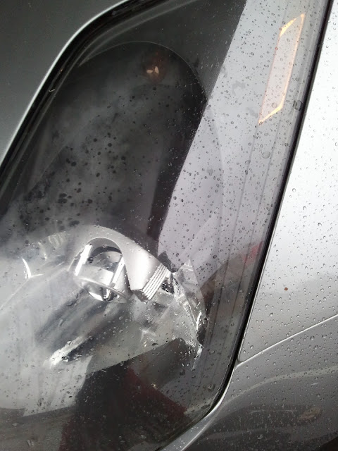

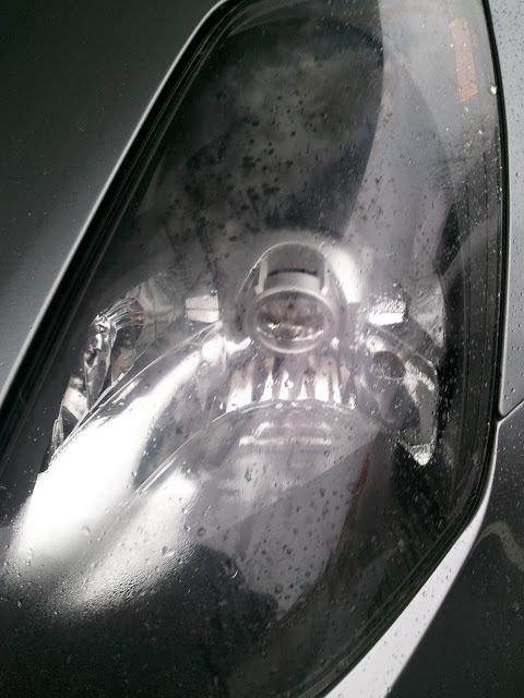

thanks that makes me feel better. i used plastic rattle can spray. i used the clear silicone to seal it back up. but i think i wanna take it apart again and paint more of it.
heres my left and right lights, i know i need to refinish my lenses, but you can see what i didnt paint. its raining also.
and heres a shot of my side marker, i painted it, but left the spot where the light shows through.
can i black out everything, or has anyone blacked out everything except what i circled?

is that condensation? ... if so.. I hope you didnt assemble the unit
Old Dec 25, 2010 | 03:05 PM
dope619's Avatar
dope619
Joined: Dec 2010
Posts: 126
From: rohnert park, ca
nope its raining, i drove through the rain today. wiped it to make sure, and it was dry inside.

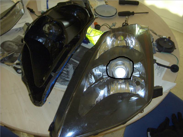

hey just to make things crystal clear, 4DGS, you painted all the chrome except
what i circled in this picture below, and that means you said bye bye to high beams, but your low beam output is fine.
i dont want to lose my high beams or low beams, but want to black out as much as possible, so should i paint everything except what i circle in this picture below?
