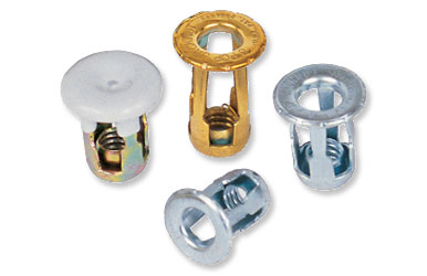

I finally got something to work. I went to Fastenal and got some Jack Nuts:
Jack Nuts have a washer type head on them and they are threaded at the bottom. When you thread a bolt into the Jack Nut it swells and pulls itself tight against whatever your bolting to (i.e. the 350Z body)

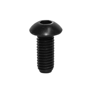

I drilled out the factory mounting holes for the side skirt to fit the Jack Nut. It was close to 3/8" I believe. After popping them into place, I aligned the Nismo skirt up and used 5/16" Allen or Hex button head screws to use with the Jack Nuts:
Once I got the screws started, I hit them with a drill and all of them squeezed together and the Nismo skirt is firmly in place. There is no way it could ever fall off
Attachment 310235
Attachment 310236
Time to find these locally, i have skirts that i need to install
They work great. I got mine at Fastenal. I'm sure Lowe's or Home Depot would have some. I'm not for sure the exact size on the Jack Nuts but the Allen screws were 5/16". Drill out the factory holes just big enough to pop in the Jack nut.
