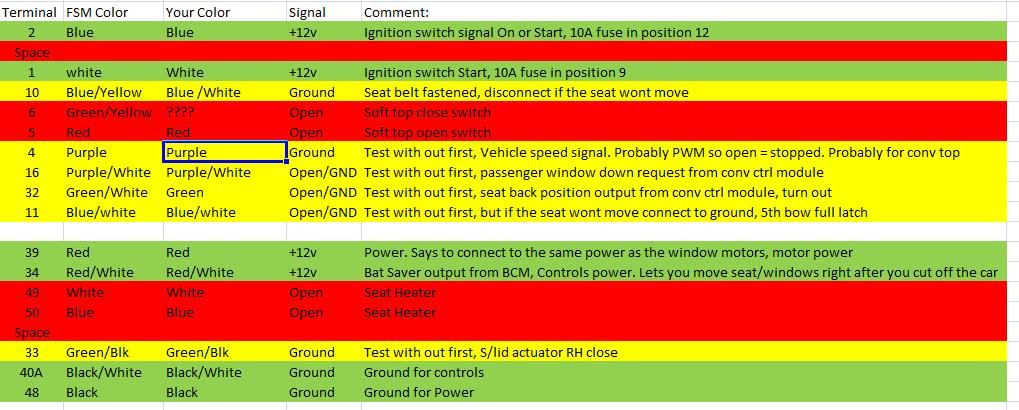

Dont forget that the black and white wire on the switches need to be grounded as well.

uploaded an updated list with more descriptions/colors.
Getting close.
You may need some of the ignition signals and you may need a few off the convertible top controller signals (which are most likely ground signals and may prohibit movement of the seat)
if i discconect the blue yellow ground back button stops working...im sure its a ground...will go through them

^ yeah that is to protect the user if they are sitting in the seat and the seatbelt is being used. You cannot accidentally hit the button while someone is sitting in the seat. That should connect to your seat belt clasp. I would definitely install it properly since it is a safety concern.

i have red, red white, white, and blue for power
for ground black, black white, blue yellow
and i tried other grounds still no luck...only rear button..
Old Dec 9, 2012 | 05:05 PM
  #45

i would try 4,11,33 tied to ground.
i made another discovery....i manually moved the seat back...the reason why the controller clicks...is because the seat will only move forward...if i move it back manually by jumping motor then i can move forward with switch...but thats it doesnt recline, or move back..
just 4,11,33 or along with what i have

disconnect the white power and leave the blue power. This will make the controller think the car is on.

Cux, if it helps any, that definitely is a roadster seat. You can tell by the cancel switch in the first picture in post #29. (The seat back normally moves a bit forward when you operate the power top, it’s not really necessary and cancel switch eliminates it). Also some of the wires in the controller are to lower the side windows before the top opens.
Just a thought, but this being an 07 might it have a sensor in the seat to turn off the air bag if no one is setting on the seat? I’m not what year that change came about, also turns off the airbag if a small child is in the seat.
in addition to what you have. These are signals from the convertible top.
The seat may not recline back because of the position of the "top"
So FWD works, the buttons on the back work. Now to get reverse to work and its done!!!???!!

forward works and button on back works...just back and recliner don't work....i tried those additions it didnt work...i have seat flipped upside down...u think that matters?

GND 32 and see what happens.

Pin 32 may be it. They call it the Seat Back Position output from the conv ctrl module. It may be the enable signal for reverse controls.

If fwd is working you have it already. It is the black with white tracer on it. Dont worry about it.
focus on pin 32....

nothing w 32

keep 32 gnd, undo 11 and 33
