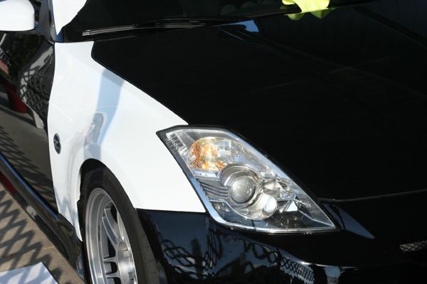

Did some more work.
The cold weather really makes this stuff difficult to work with.
Had to stop due to rain.
So I vinyled up the X.
