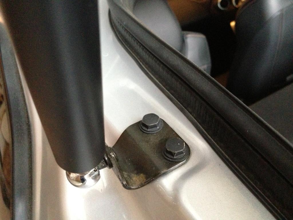

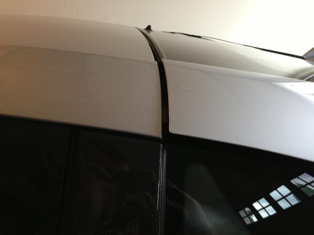

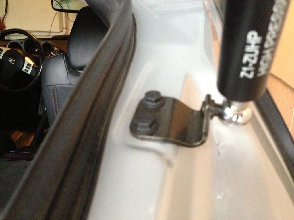

Hi Guys,
I had some Z1 UHP hatch Struts installed a couple of months ago and I've noticed that my hatch is no longer aligned to my roof. Perhaps the struts were not installed correctly or it's the added high pressure of the struts forcing the hatch up. I've attached some pics...
Any help sorting out this issue would be much appreciated.

the brackets are upside down. take the 2 bolts out of each bracket, flip it over, and bolt them back down. problem solved!
Thanks man... I'll flip them over.
Easy peasy japaneZey!
Yes. I have the same struts and just checked to verify

brackets have been flipped... problem solved.
thanks Bmurray
