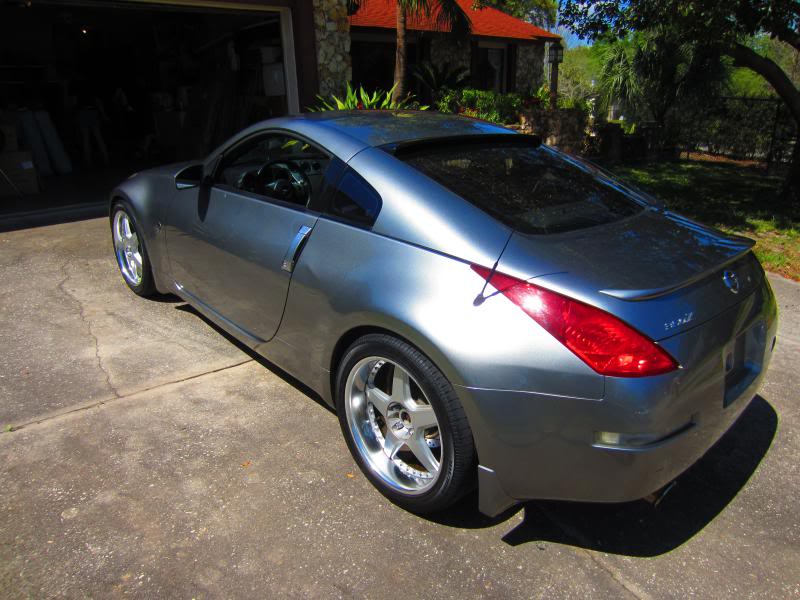

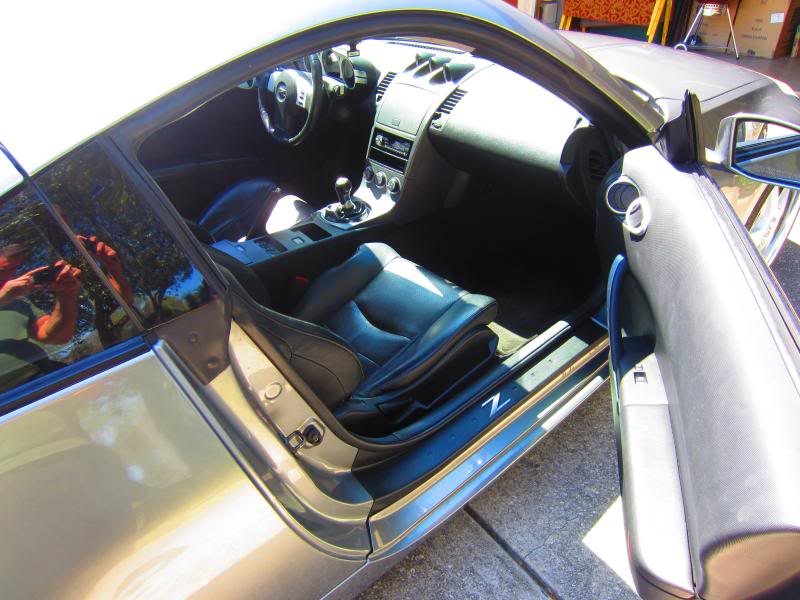

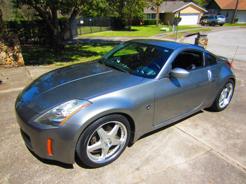

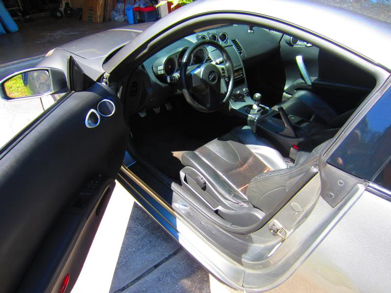

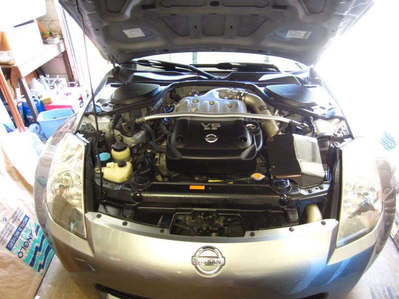

After a lot of searching and self control I have purchased the sixth 350z I looked at £7750 - 118k miles 2003 touring edition in metallic gray, leather seats, LSD , racing hart deep dish rims (too deep for the car I think) got some leaking around the valve seals but still a bargain at that price I think.
Thanks to everyone who helped out with guidance and advice along the way, I really appreciate it.
