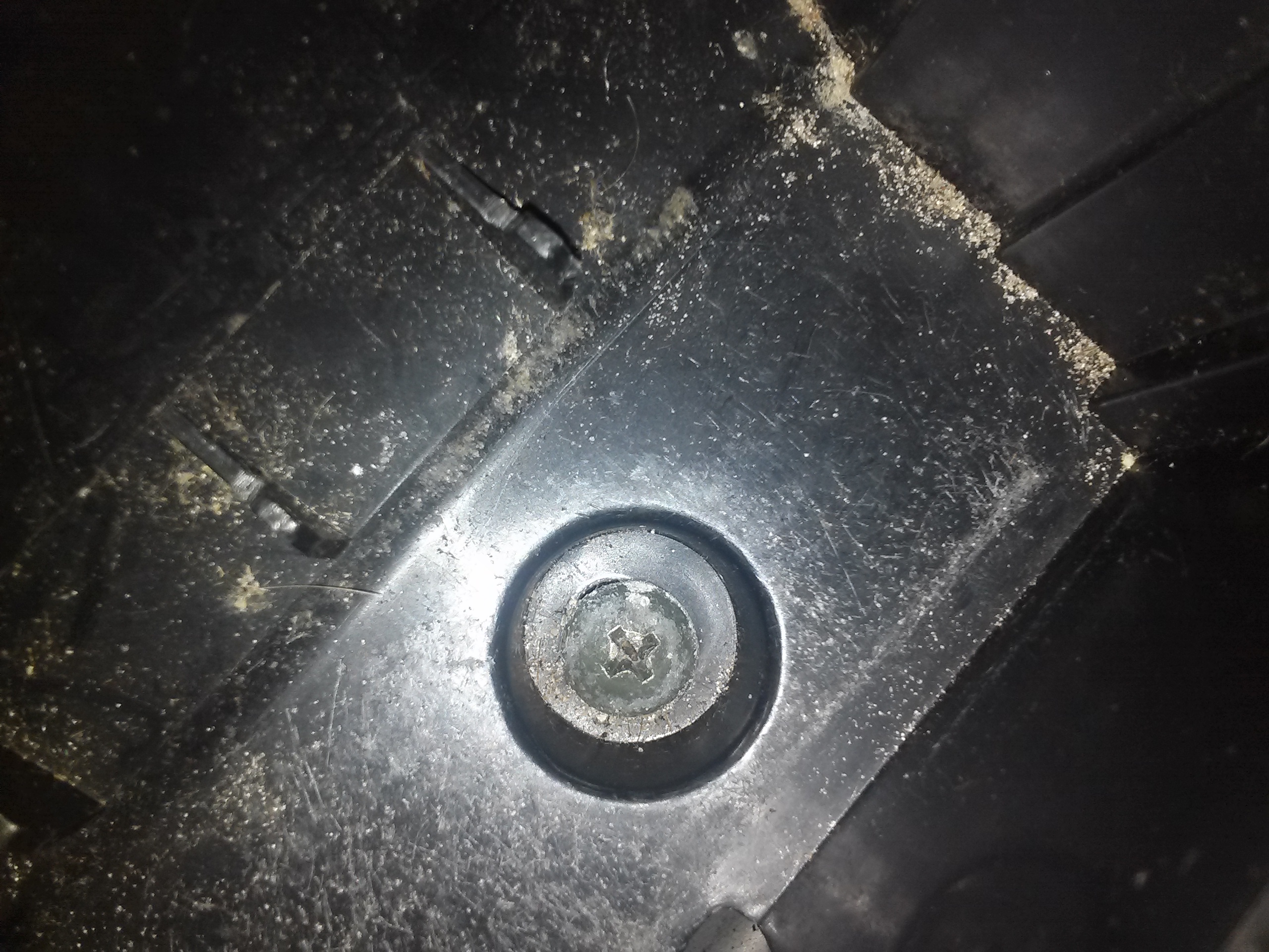

Hi All. So my coin tray wont stay seated when I open it. The whole thing kind of pops out of place. I assume I'm missing a screw or something that goes into the pictured hole. I've looked at the part diagrams and cant find what it's suppose to be. I assume it was lost when I had an audio guy putting in an amp/sub in the back. (05 Touring Manual Z)

Does anybody know the part number???

Yeah, I've done that and it sits flush and normal. The whole thing will jiggle around with a just a tiny bit of force though. And by jiggle I mean it goes completely diagonal within the center console making it unopenable. So whatever goes in that hole must help brace the tray and keep it from becoming askew. The only other explanation is something snapped off or broke in the center console but I can find no evidence of that.

My coin tray has done the same thing since i bought my car. I can not recall if I have a screw in that hole or not. But I did look closely at everything and part of plastic that the tray slides into is broken. Like there are two plastic slots that the tray slides down into that compartment, one of mine is broken and I believe that is what causes mine.

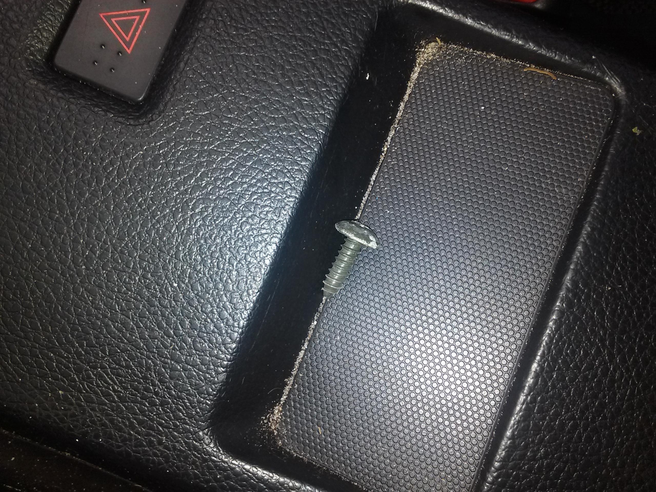

Is this what you were looking for?

A screw does go there but that's a console mount screw. The coin holder/ash tray just slides in and mine holds firm with no jiggle.

On the left side of the coin holder/ash tray is a little metal piece that is kinda curved,and held on by a screw you may need to bend it out a little more so it holds it in from popping out. I had to bend mine out a little when I got the car, no problems since.
