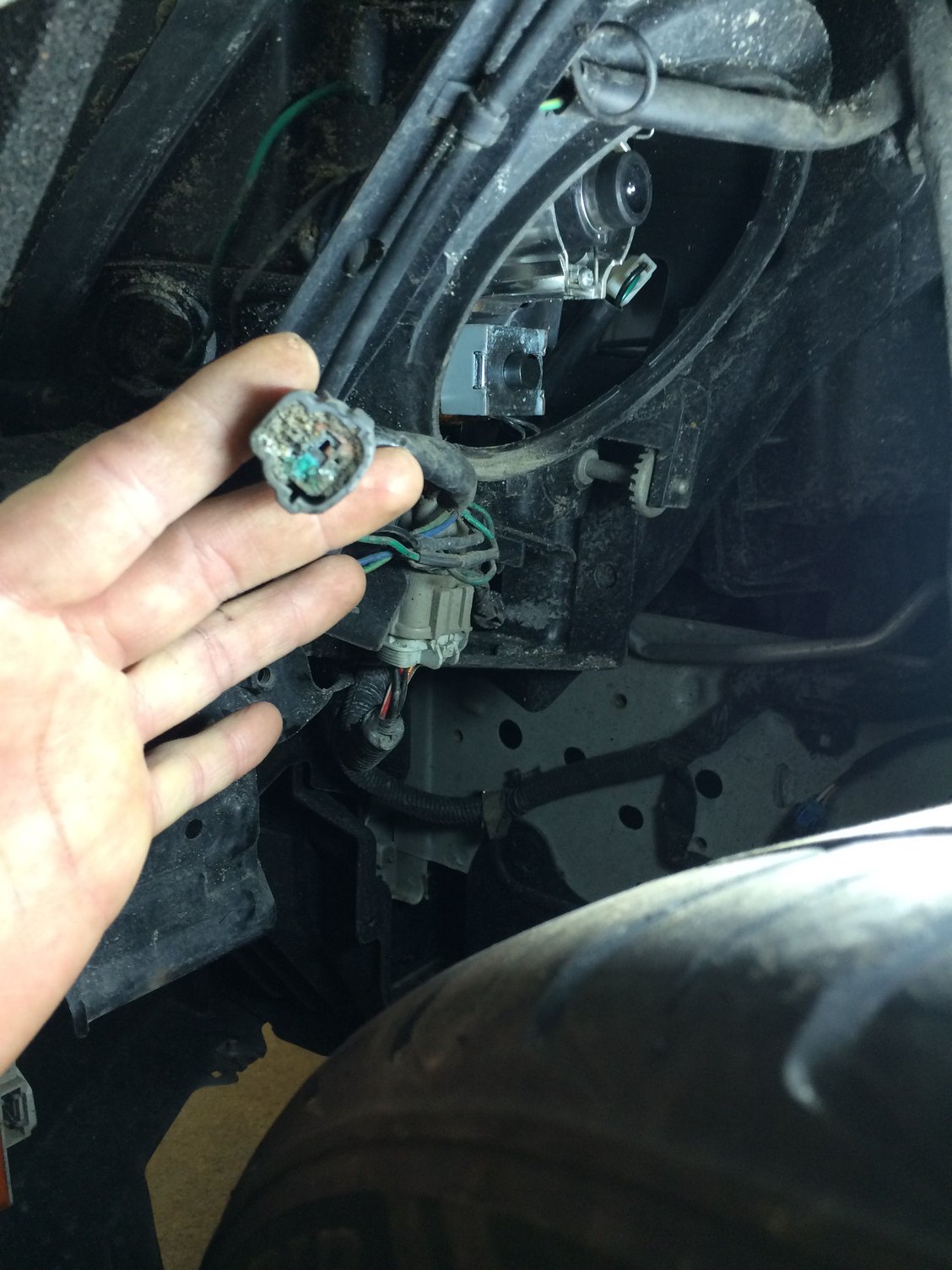

Couple months ago I had a dealer installed HID lights that's are 55w. They work great and they are brighter than HiD oems. The problem is now the ballasts blow up. I tried contacting the web site dealer and I've read for as hid recommend for 350z and they sux.
So now I'm trying to take out the hid aftermarket and install back oem but theirs a problem. The dealer ****ed up my oem headlight wiring (splicing, missing, misalign) that i had to purchase new oem ballast since they are missing and a wire connector that's connected to the back of the headlight. I do not know which wire harness it is but I have several pictures. What kind of wire harness is this so I know what to buy?

I would chop it off and find a salvaged z/g off craigslist that is being parted out. Take the pigged-out harness with you to make sure they match and offer the lot attendant $5 ... I've done this twice now with pig tail harnesses and it's worked out well both times...It's such a small part and small dollar amount I think they just pocket the money. Solder it to your main harness with some heat-shrink or electrical tape and call it good!!
