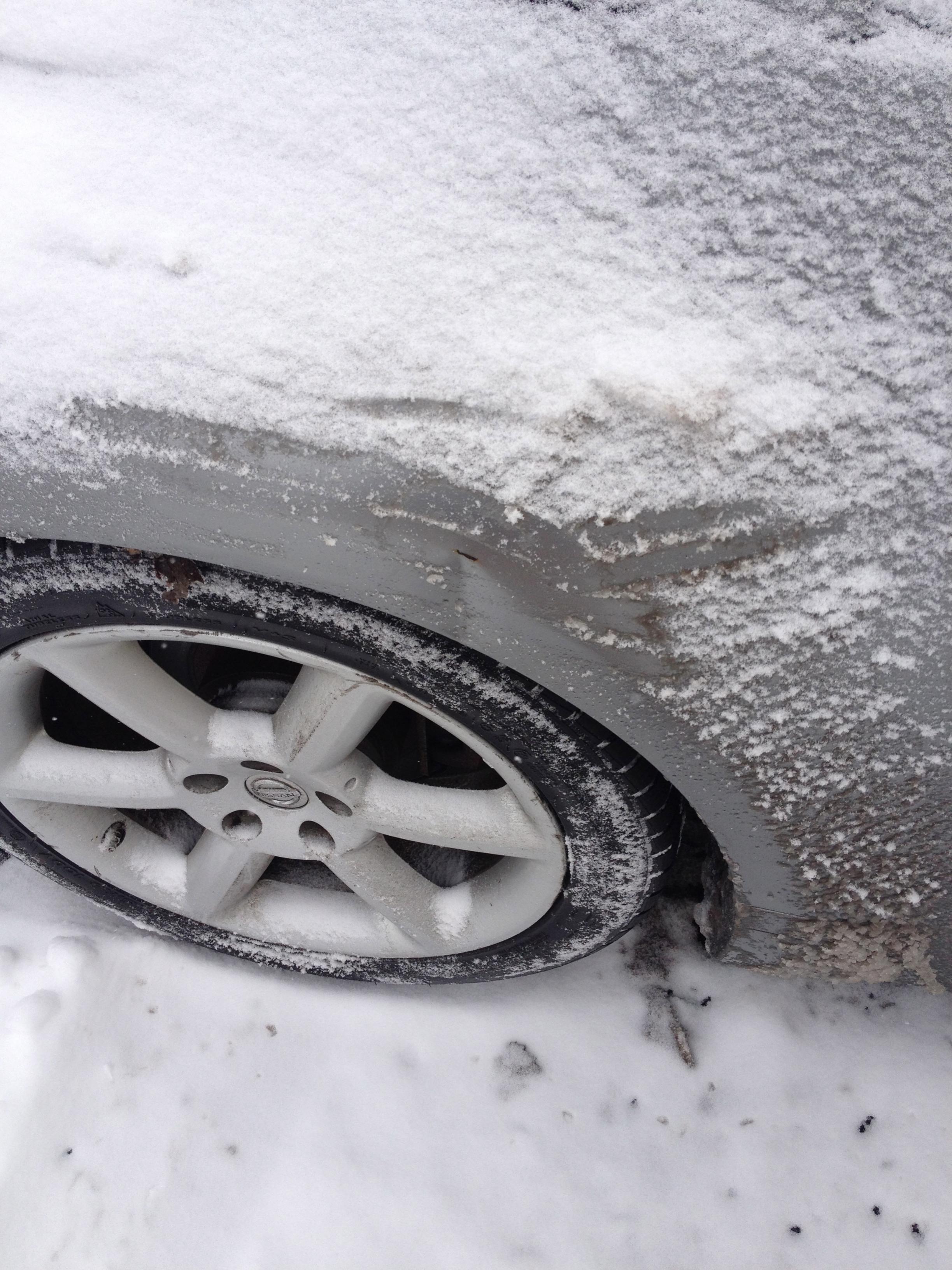

So someone thought they would have fun with my car while I was at work. Dented the right quarter panel, painted cracked on the left quarter. I'll post up pictures but I want to know if I'm getting ripped off. I'm finding it hard to believe the body shop can only order a new quarter panel for the right panel. The left they would have to paint but the right is what I am most skeptical about.

Sorry about that I just had a change to put pics up this morning. It's snowing here in Ohio but you can see the dent and crack in paint. The dent looks smaller than what it is in person but the point is the location. They say because were it is they have to get a new quarter panel?

is that the rear? if so that is going to be EXPENSIVE, they have to cut factory welds to get it out

Yup the above comment is right. I had a ding on my right rear quarter panel and the cost to repair was well over half of what I paid for my 04 Z. At-least the other person's insurance took care of it.

They are correct. It's right on a crease. They could pull it, but it would never look the same.
Sorry, but this is going to be a relatively expensive job if you want it done right.

Those didn't just happen. Both have rust on them.

Both look repairable, but I'd have to see it when the car has been washed. At least once.

Correct, they were a month before winter. Just now able to do something about it financially.

Thank you for all the replies. You guys were dead on with what the body shop said guess I didn't want to believe them. I'm wondering if it would be better to get my insurance involved since it is vandalism.

My deductabel is 1k so I'm probably going to be spending a little more for the quarter panel and paint on that one alone. I'm just hoping I won't have to get the whole left quarter panel painted I'm more worried about the rust forming on my door handles and left side mirror not sure what to do with that. This thing has been killing me in the last year

They could probably blend the left panel.

Have a Paintless Dent shop look at it first. They may be able to help you out a lot cheaper depending on how bad the rust is(think $200-$300). Worth a shot if you ask me. You'll have to get it repainted but it will at least get the panel back to 100% then its all about taking care of the rust.
