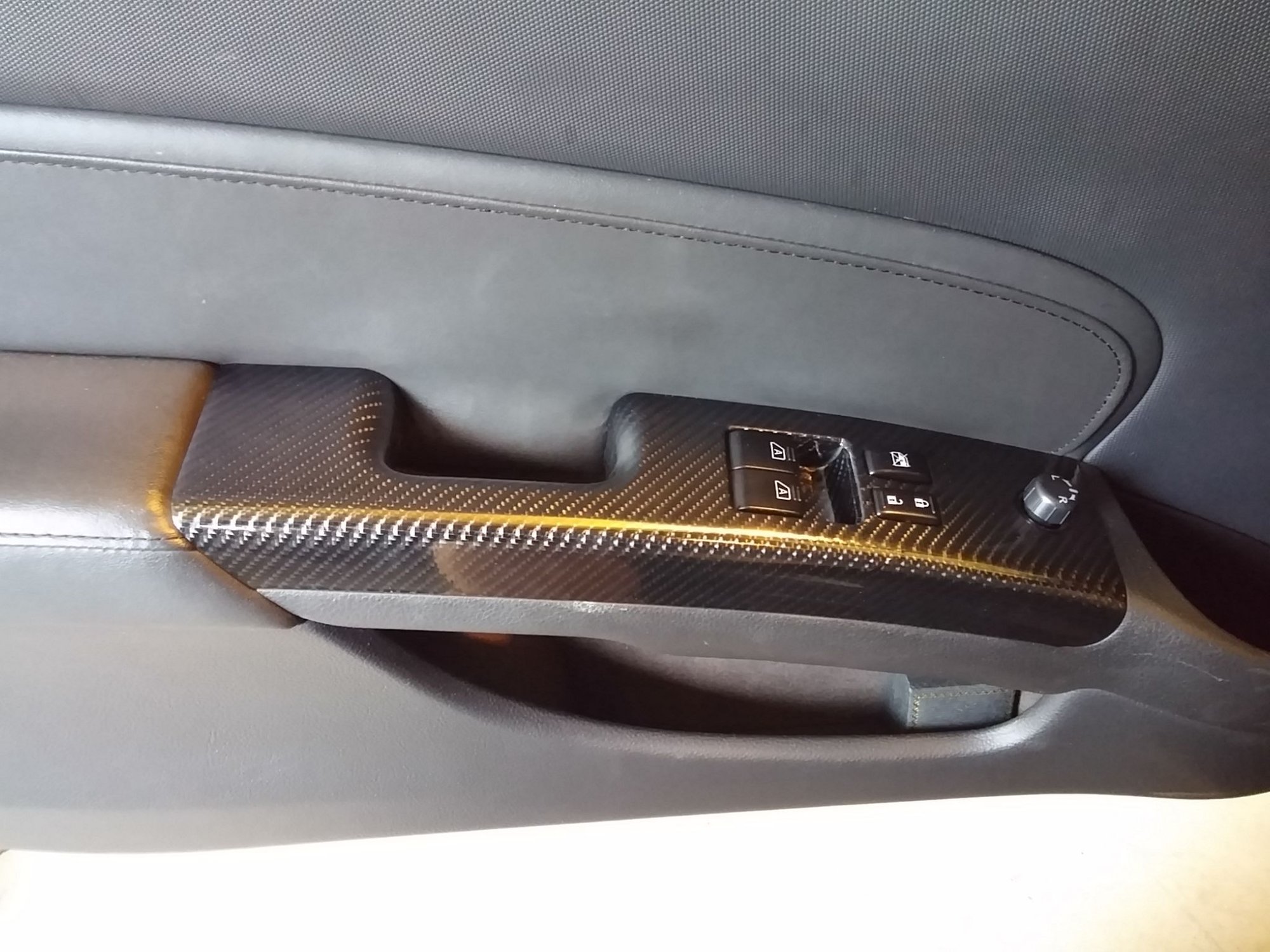

I wanted get some c.f. for my interior but they are way too pricey and the stick on c.f. looked kinda cheap. So I decided to just wrap the interior with some 6D c.f. wrap. I chose the 6D Because of the gloss and It's resemblance to real c.f.
let me just say this was not easy at all, lol. Esp with the 6D the vinyl is thicker with the gloss, so the center console was very difficult to do... Omg my fingers all sore and hot and cut, but it came out great.

Looks good. Where did you get the stuff?
Old Jun 6, 2016 | 03:45 AM
Cux350z's Avatar
Cux350z
hatersgonnahate
iTrader: (162)
Posts: 15,390
Likes: 1,085
From: Greenville, SC
looks like legit CF. Well done.
Old Jun 6, 2016 | 04:35 AM
Golden_Armz's Avatar
Golden_Armz
Joined: Apr 2009
Posts: 300
Likes: 10
From: NJ
The 6D carbon fiber is kinda cheap. 5ft x 5ft I paid 50 bucks. I bought it from hachiauto.com. the window switches were very easy to do. I still have some c.f. left, if u want me to do them For u, pm me.

UPDATE: after sitting in the sun, some parts around the controls have come loose and start to bubble up, didn't use adhesive promoter but now I realized why. Around the edges they come loose with heat. I might have to redo them....

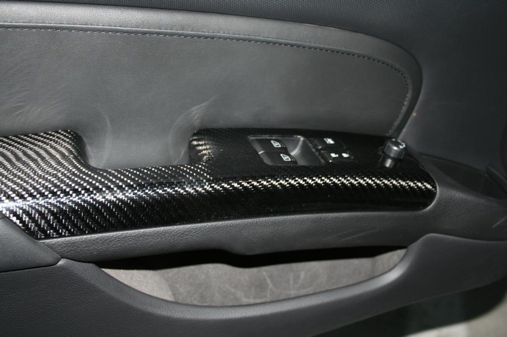

Yea, I thought I could get away with not using the adhesive promoter since the vinyl itself is sticky, but I was wrong, lol. I actually have the spray but decided not to use them.
here's a pic for evo R website. The real CF. They actually look the same.
