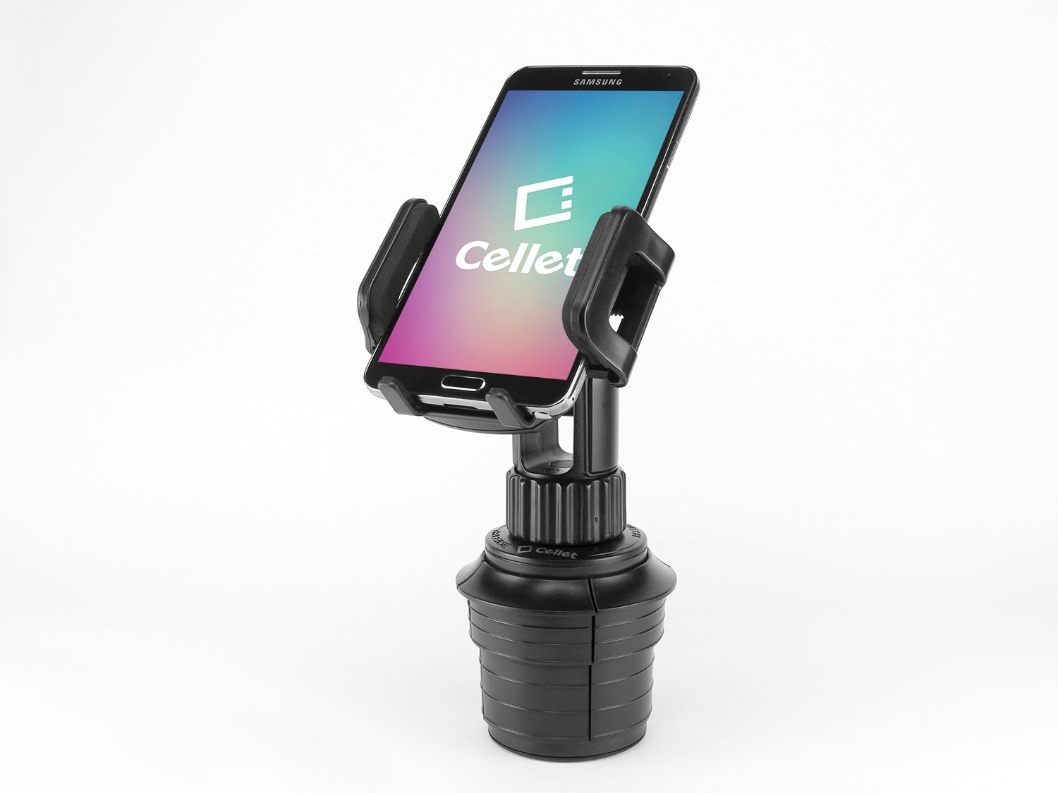

could go the cupholder route

I guess my phone is sort of relevant, but arent most of them adjustable? I have a Sony Xperia z3v.
I like the cupholder idea though because that one on the right by the passenger seat is useless!

I dont want a vent clip one either i think because the vents in the 04 Z are not really the right size or in the right orientation. I was thinking a windshield one but i don't love the idea of obstructing my view even a bit. I think cup holder mount is the winner
