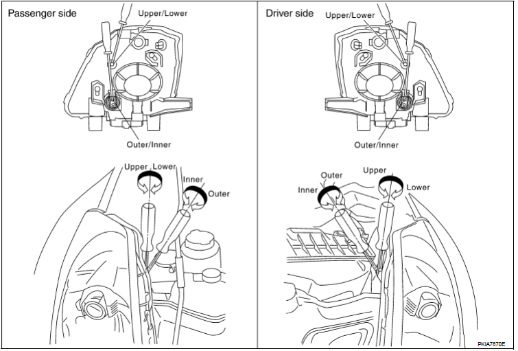

Also, is there another gear that I can turn to adjust them? I only see one and it adjusts up and down.
You might have the horizontal adjustment ****, and you might not. I do; but some oem housings won't. You'll have to see if yours do. Here's the location.
