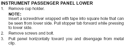

Old May 14, 2004 | 01:21 AM
ether's Avatar
ether
Posts: 694
here are the official instructions.. I suggest going through the top.. the manual says to go through the bottom..
you decide
