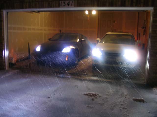

http://www.importhookup.com/ is where most ppl got their after market H7 HID kit for the base model. I bought the 6500k kit and the color is awesome but still not purple enough for the cops to stop me. U will need new housing if u are planning to buy used 350z hid because the base housing is diff than the hid housing that holds the bulb.
My hid compare to acura hid.
