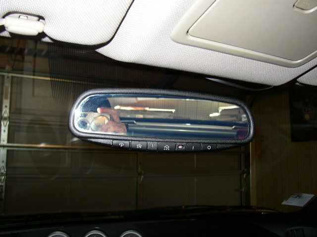

Having done MUCH research into competition belt mounting, I'll offer my thoughts.
Comp shoulder belts should be mounted within 10 degrees of a horizontal line resting on the drivers shoulders. Your drawing puts the belts too low. My bar is a tad high for my 5'10" frame, but still within the 10 degree rule.
As for the BCR harness bar blocking the rear view........NOT! It is below the height of the rear strut brace when viewed through the rear view mirror.
Wish I could do the MS paint thing......
Here is a picture I took through my rear view mirror:

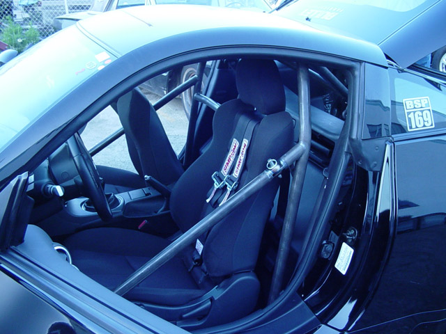

This is a custom one someone made, I don't like the diagonal beam going by the seat.
