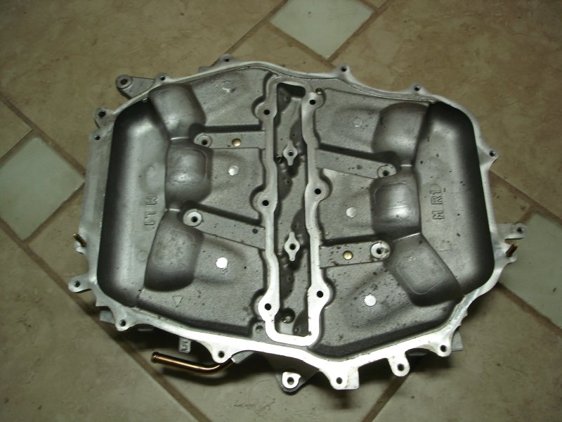

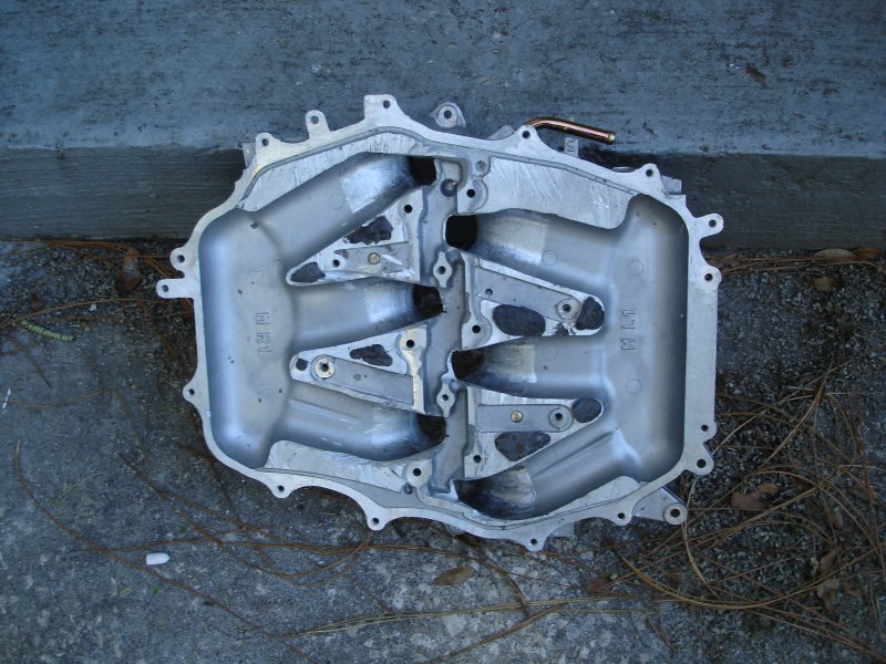

cool man.... i actually took the lower plenum and cut all the runners out of it with a sawzall, big die grinder and a dremel.... i can tell it is going to be sick once i get the right amount of fuel to it, i will be sacraficing a little bit of torque for a lot of horsepower, i also matchported the lower runners and opened them up a bit, the stock lower runners actually have a nice little lip on them on the head side of them from the factory, right now i am running really lean and need to figure out a simple way of either raising the fuel pressure a couple psi or getting bigger injectors and tuning them down to the right place so my A/F is good...
just trying to unleash some of the potential power on these engines without spending millions of dollars on useless mods
anyone have any ideas how to bump up the stock fuel pressure without adding a 1200 dollars return fuel system...
i was thinking about adding a walbro pump, but that raises it 20 psi, then figuring a way of acutally lowering the fuel pressure when i do it, i was told that the walbro doesnt really like the returnless fuel system and possibly will quit working cause it likes to have a return system
thanks and hope to hear some feedback
here are a couple pics, this was an experiment so it is not the finished product, i filled the holes it made with some epoxy to keep it from having any vacuum leaks, if i could get it to run better i would definently get it welded with a tig welder using aluminum, hopefully i can figure it out....
