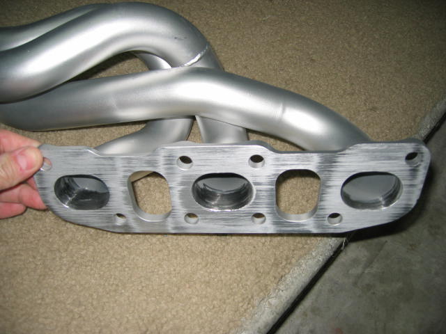

I have been doing my homework on this one,
It seems that we SC'ers may lose power with the addition of headers due to the loss of back pressure and overlap of our stock cam design.
I have my stock headers off and they are very restrictive, 1.6-1.7in
collector!! Can you say tiny?
I bought DC headers and the collector is 2.25 plus a clean shot right out of the head instead of the stock "welded" header exhaust port.
Does anyone have any #'s for me on this or first hand experence?
Thanks,
ZNitro
