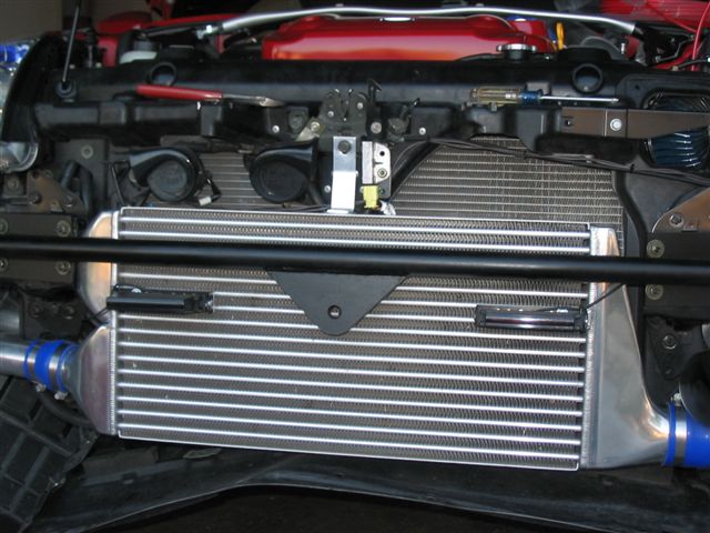

i made a steel bumper with a place to screw in the tow hook

heres a picture of what i made and yes its been tested
man that is awesome you should make more and sell them on the forum? do you have to take of your front bumper in order for you to tow it? are you using your stock bumper or do you have an aftermarket bumper?
Any interest in making a couple more of these. Or at least one more?
I am also interested in adding a flat edge or plate towards the passenger side, so I may mount an oil and/or power steering cooler to it.
Any thoughts?
