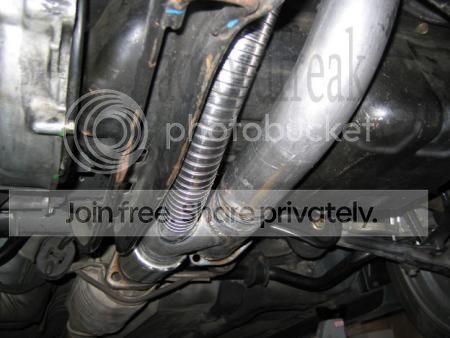

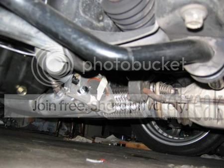

oh and the quicktime cutouts fall apart.... the motors fall out..
here's a picture of the ATP vaccum operated one.. you could probably put a boost controller on it too to make it open at the desired PSI ..lol pretty neat.
