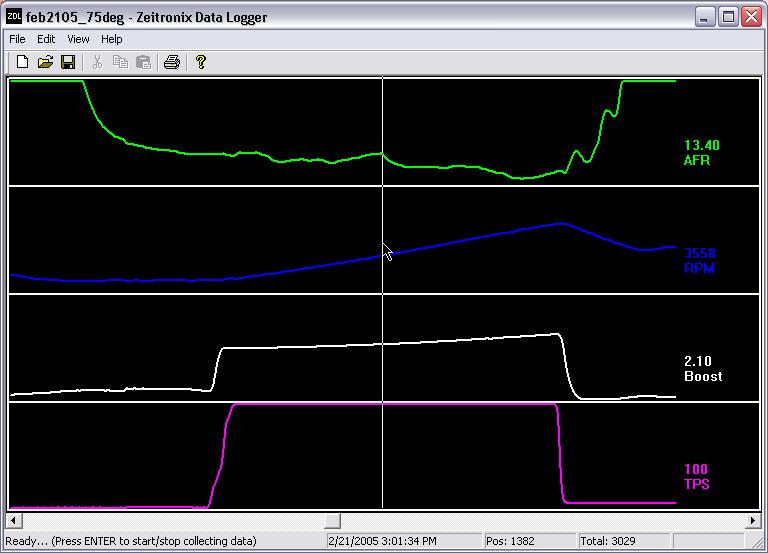

So this is one of my graphs. If you only make small adjustments, like change 10 to 10.2 or 10.1, it's pretty safe. I think your sampling rate might be low also.
My tps shows 100, but that's because I selected View->TPS-> calibrate to plot range. Before that, it always read like 87% or something.
