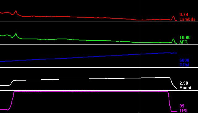

Bill, I had my ECU 'limited flashed' by TS. Just did some dyno pulls and data logging using Zeitronics. TPS was displayed on the graph at 99%. Not sure if it will even show 100%.

I have the TS "Limited Flash". Data logged six dyno pulls on Thursday with Zeitronix. At WOT, TPS ranged from 98% to 99%.

I bought the OBD from Zillinois . He got what I got ...85% . SungNamZ gets 98% with Zietronix
zBicklin get 83% with Zietronix

booger, if I recall, didn't you have to return your ECU to TS to have your ECU reflashed. You once had the "full" flash and Vortech SC was looking for OEM ECU with exception of rev limit, throttle and speed limit. Maybe, just maybe, TS didn't get it right.
I did the "Limited" flash and showing throttle at 99%. Trying to figure out how CaneZMD is showing 100% on his Zeitronix data logging.

When you get your Zeitronix back it will be easy see. My Rev Limit is also at 7200, with no speed limit and 100% Throttle. I will watch for your future posts or send me a PM.
