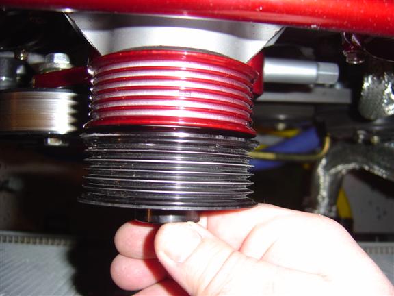

Thanks for the info Guys. Stage 3 pulley looks much bigger than the one on there. Is this right??

Im assuming stage 3 is more boost than stage 2, which on your s/c should be a smaller pulley. Are you sure your looking @ the correct pulley? BTW where in MD are you, Id love to run a Stillen s/c Z.....

the red one is the stage 3, the black is the stage 2. you can see the red is slightly smaller.

Stillen sent me a GOLD pulley and it is bigger than the original stage2 pulley,
I called them and they said it is the right size...?? I always thought higher boost pulley will be smaller. How about it?

Think about it - What if you had a one inch pully, and the belt is crank driven just as fast.....the little pulley would make many more revolutions per foot of belt...
Your Stillen rep needs a math lesson...

Sales person at Stillen said "You need a bigger pulley to get bigger boost" I'm gonna have to call them again tommorrow. Any one here with pics of stage3 please post. Thanks.
The information is within this post - read again carefully - and open the link
to show the red pully.. the red pully is smaller Stage 3
The shaft of the blower will run faster ( more RPM's ) with a smaller pulley...
In Stillen 350z the crank pulley is not changed the Blower pulley is changed..
Rogue23 please roll a pencil and a beer can accross the table...
