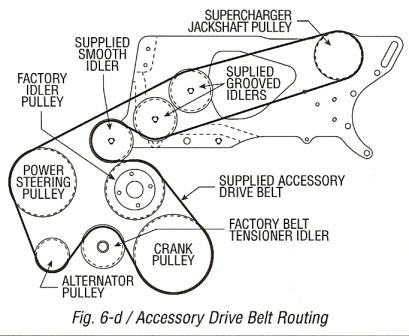

I have an image of the pulley you need to loosen. It has either a 14 or 15mm head on it... The bolt you need to tighten can be seen from under the car... let me go see what I can find. I've got photos somewhere...
(check this post later for edits).
The factory belt tensioner idler is the 14 or 15mm bolt that you loosen first.
Here, I cannot find the post I made as quickly as I came across turbomaxima's...
http://g35driver.com/forums/showthre...hlight=tighten - this post has pictures...
Attached Thumbnails vortech belt and pulley questions-tensioner-pulley-picture.jpg

Perfect. That link was exactly what I was looking for. Thanks Neffster.
