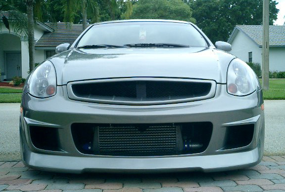

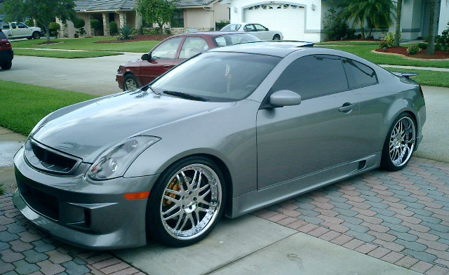

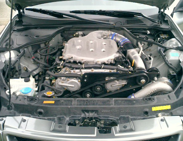

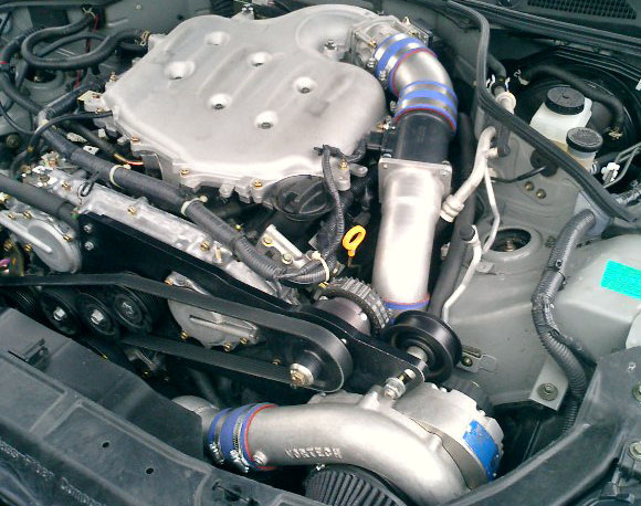

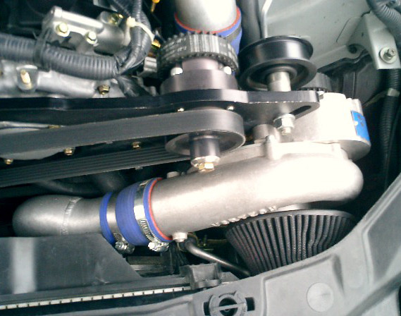

I wasn't sure about it but I figured it should it close only after throttle is applied but I figured it would close almost instantly rather than after a few seconds. Here some pics after the install.
