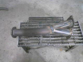

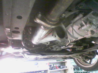

Take a guess boys and girls... Early stages but I think you'll get it!!
Attached Thumbnails Can you guess what I was making with the welder tonight?!?!-cutout1.jpg   Can you guess what I was making with the welder tonight?!?!-cut2.jpg   Can you guess what I was making with the welder tonight?!?!-cut3.jpg

crazy looking bong. but why's it underneath your car?

Would that create any wacky back pressure waves or such when closed?
maybe not, dunno.
but cool that you can do it.

how do you plan to open it remotely?

pretty cool. I'll bet the car will sound sick open test pipe/downpipe, but this will affect tunning because you need to be tuned for open or closed.
But pretty sick

one3502nv's Avatar
one3502nv
Joined: Feb 2005
Posts: 377
From: NJ
The cutouts are from Quicktime Performance and are electric cutouts. I am working on the 1st Z prototype which may be produced in the future as a direct replacement for the cats... As stated, they have electric motors which open and close the via a toggle switch.. Really an awesome setup but only sold as a universal part... I am playing around with different setups to see which position works best... The flange with the motor is obviously not attached yet but will be tomorrow... I will be racing with them OPEN this sat at Z day so we will see if any difference!! As far as tuning,, really depends on your setup.. The unichip that comes with the APS kit is MAP based and Boost dependent so if it makes any more boost with the open exhaust it will compensate with fuel... I will be doing some before and after dyno's though in the near future... Just waiting for my APS plenum which should be here in 2 weeks... I will post more pics tomorrow night when the motors are mounted...

pardon my ignorance but what are these? I am unfamiliar with this item and can not figure out what it is and what it does. What is it and what advantages does it provide?
Old Jun 23, 2005 | 08:55 AM
Brandon@Forged's Avatar
Brandon@Forged
Forged Internals.com
Posts: 5,566
From: Valdosta, GA
430ztt, one inlet, two outlet tubes/pipes. One of the outlet tubes/pipes has a valve that can be opened at any time (programmed to open at a given RPM and etc.), it has nothing after that (it vents right there). The other is just a pipe/tube that goes to the rest of the exhaust. Im guessing you put one on each downpipe (or make the cutout your downpipe). You tune for each and you're good to go. (it should make more power, that's the reason for this)

For those who are coming to Z day this saturday,, you will be able to hear it in person... And I don't care about boost controlled because I will only be using them for racing... And the occasionally drive by on the street!!.. If we get them to fit where we want them,, then a production direct bolt in replacement may follow... The 2 valves with hardware alone sell for about $350ish so figure in the $550 range for a complete bolt in cat replacement piece.... The beauty behind this is that you can run any exhaust you like regardless of design or power gains, or back pressure and at the flip of a switch, have a wide open no resctriction exhaust.... !!!!
