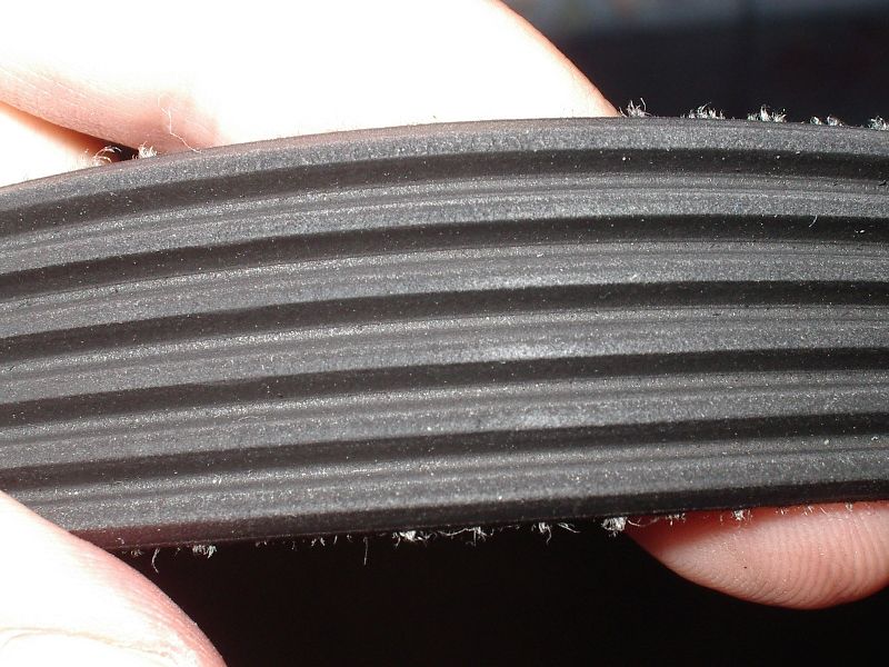

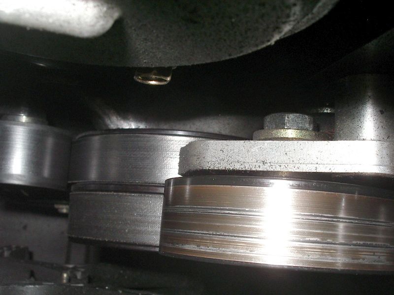

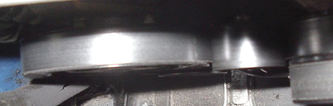

Default Pics of the belt

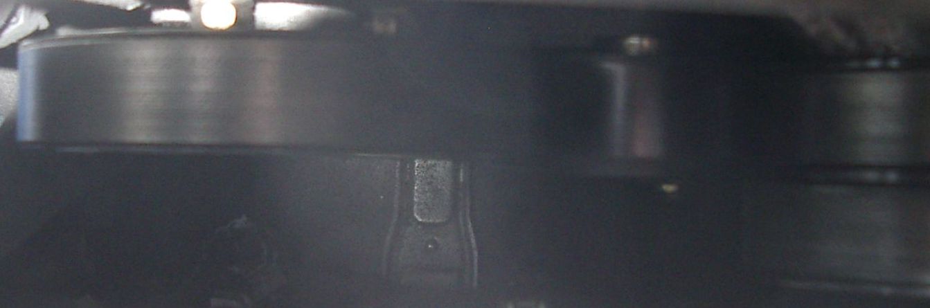

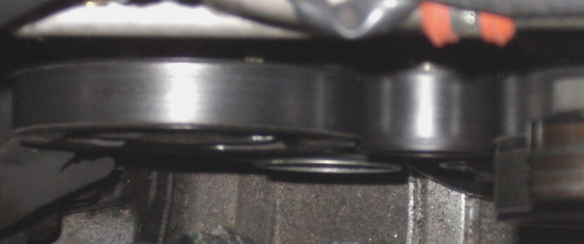

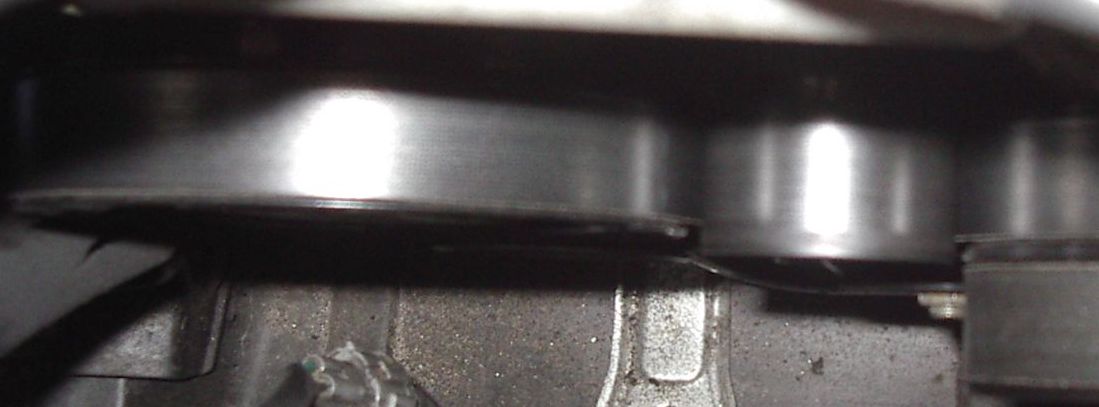

1st pic: belt location (look at the upper belt)
2nd pic: old belt, wear
3rd pic: old belt, wear (diff angle)
Attached Thumbnails Need help from fellow Stillen SCs!-beltslip03sm.jpg   Need help from fellow Stillen SCs!-beltslip01sm.jpg   Need help from fellow Stillen SCs!-beltslip02sm.jpg
Old Jul 5, 2005 | 09:11 AM
zparts's Avatar
zparts
Posts: 96
From: ca
Have you installed the shim kit on the idler?

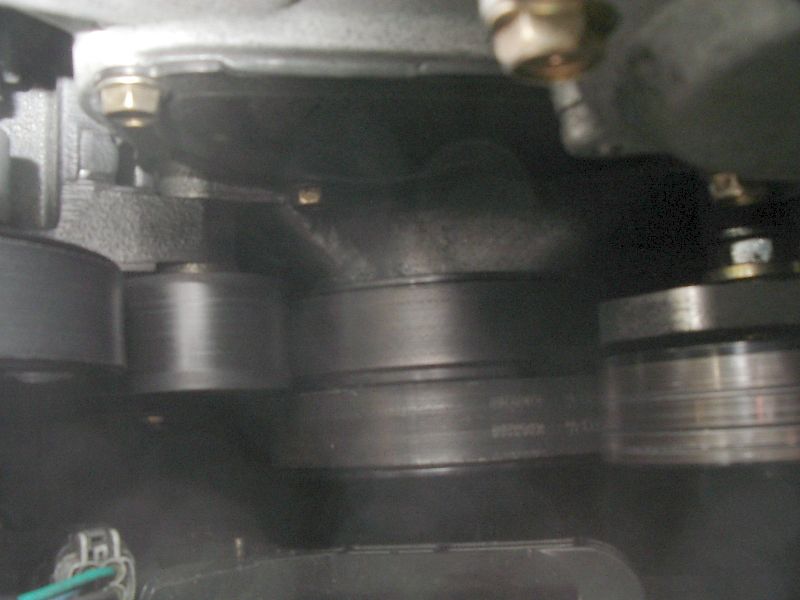

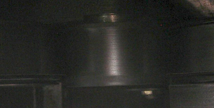

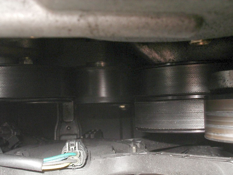

So, this makes me think, which pulley could be mis-aligned to cause the belt to grip with only 1/2 width and get eaten the way it is getting eaten. So, I'm staring at the pulleys from various angles, when I see it -- the power steering pulley is ever-so-slightly tilted inwards (towards middle of car, width-wise). Once I spotted it, it became more clear. And, not just the pulley (it would wobble if it was bent). The whole Power Steering assembly is crooked! WTF?! I never had this replaced or moved to my knowledge, the only thing worked on was: some suspension changes, wheel changes, SC install, alternator replaced.
So, it could be:
* Manufacturer defect that was not showing due to better-fitting Z belt (SC has Gates belt, different groove angles) and less load (no SC). SC was installed at 8K miles, so perhaps the defect would've shown itself at around 15K or so naturally, but it never had the chance.
* Original SC installer removed this assembly for easier access, and re-installed it crooked (SGP? Did you remove the assembly?).
* Apollo Body & Shop messed with my PS assembly. Not sure why they would, since they were fixing suspension and wheels.
I'm throwing out any possibility that PS assembly is moved when alternator is replaced. I know Tom@LightSpeed, he'd tell me if that was done. So, the three above are possibilities. And, yes, I'm looking to point finger now, I've spent a good deal of $$$ troubleshooting this and for a year had to deal with crappy performance and belt slipping.
I'll be getting a laser leveler in next few days and will post a pic, if it shows clearly how the pulley is not aligned.

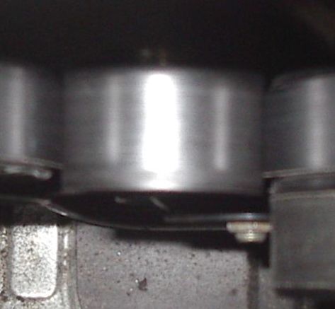

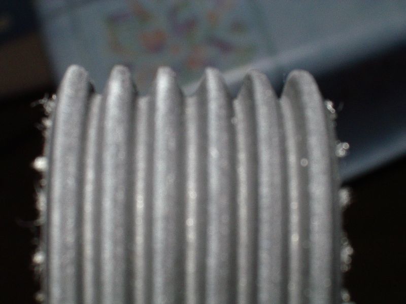

I went on a business trip, came back, forgot to post the pictures that show alignment issues. They aren't the easiest to take, so I'll thank ahead to anyone who goes through the trouble of snapshotting theirs.
Attached Thumbnails Need help from fellow Stillen SCs!-misaligned_ps_pulley06.jpg   Need help from fellow Stillen SCs!-misaligned_ps_pulley07.jpg   Need help from fellow Stillen SCs!-misaligned_ps_pulley08.jpg   Need help from fellow Stillen SCs!-misaligned_ps_pulley09.jpg   Need help from fellow Stillen SCs!-misaligned_ps_pulley10.jpg

Unhappy Two more...
I think this shows that power steering pulley assembly is not aligned properly. The belt gets heated up pretty fast. One of the pics shows the belt residue all over the place.
Attached Thumbnails Need help from fellow Stillen SCs!-misaligned_ps_pulley13.jpg   Need help from fellow Stillen SCs!-misaligned_ps_pulley13a.jpg   Need help from fellow Stillen SCs!-misaligned_ps_pulley12.jpg
