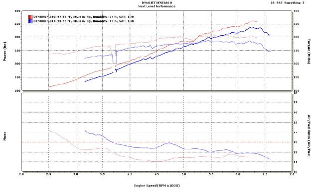

My car with Crawford Plenum, Crawford Headers, Crawford h/f cats and JIC Y-Pipe.
G8tor20's car with just Crawford h/f cats and TS ECU reflash for the higher RPM's.
