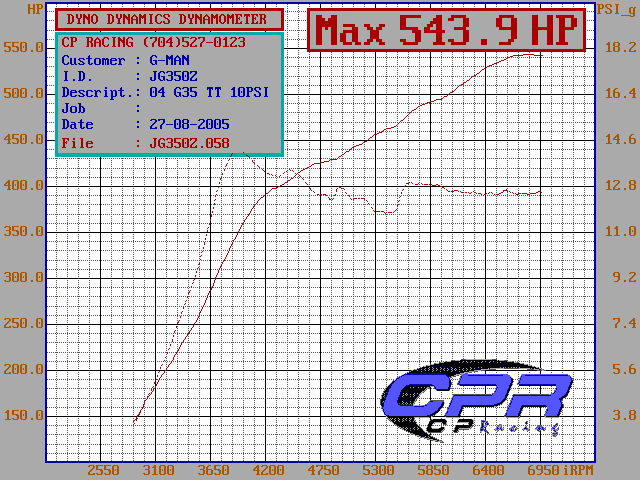

Originally Posted by ssgfunk
What RPM is the greddy fully spooled at?
Here's my boost graph. disregard where it says 10psi that was a typo.
Attached Thumbnails What is the smallest twins to make 500whp?-dynoboost.gif
Why does your boost fluctuate so much??
It's time for a better boost controller. The one I have does not work well for higher boost applications. I will probably get the blitz id soon.
