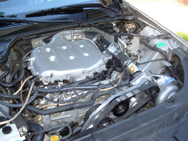

I have a ati procharger at 7lbs. conservative tuned.. 350hp..310tq. Fun to drive. Normal cruising auto mode is fine. But when I get on it I always do manual mode. I haven't done the flash. No need right now, I've hit the limiter a couple of times, no problem though. The car acted just like it did before the supercharger, a little stumble, then i'd switch gears, and go about my business. This winter I'm gonna tuned it for alittle more power. Maybe 380+hp/340lbs tq. I figure I'll bump it up with the cold/dense air, so when the summer comes around the a/f will drop down just a bit(safer). I considered an oil cooler and other such goodies, but I only track the car once or twice a year, I didn't think I needed it. I usually stay in the beginners group, where the action isn't as tough. I do auto-cross 8-10 times a year so I did upgrade my brakes to the stop-tech stage II, slotted/drilled, s/s lines better fluid. Other than that I've left her alone.
One thing about the supercharger, the sound is an acquired taste. Like the whine from a jet engine. It's not for everybody. I used fat-mat to insulated the sound somewhat, but you can never get ride of it. I like it, some don't.
