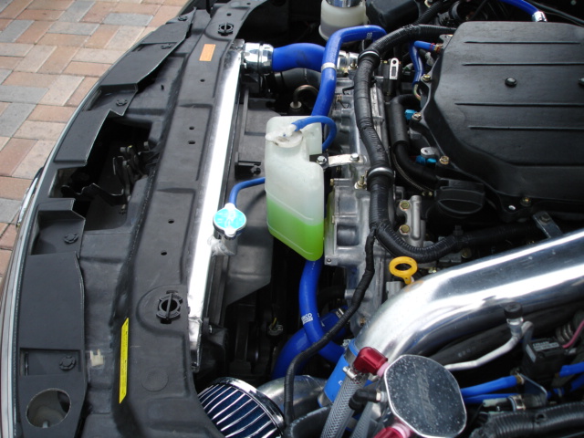

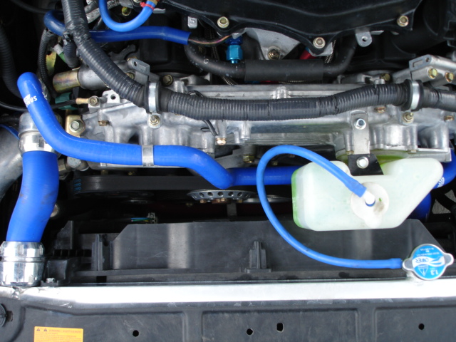

PE in G35.
Attached Thumbnails Anybody with a turbonetics single turbo kit,come in plz-radiator-003.jpg   Anybody with a turbonetics single turbo kit,come in plz-radiator-002.jpg

Gman - thanks for the shot of the radiator. Looks like it might have enough room in there for the tn piping, it would still be a very tight squeeze though.
