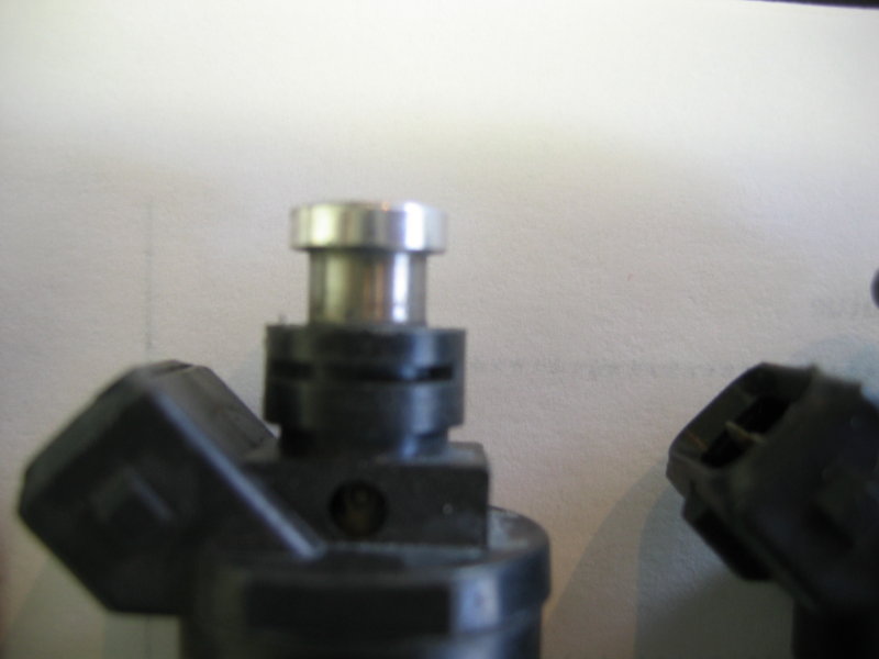

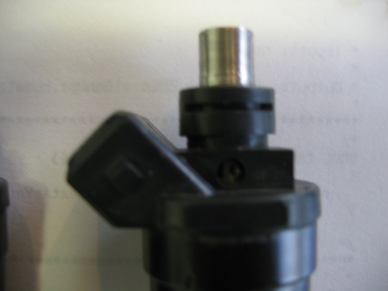

is it the rings at the top that you are talking about?
Attached Thumbnails Need Spacer size for RC440 injectors-winter-mods-003.jpg   Need Spacer size for RC440 injectors-winter-mods-004.jpg

No I guess that there are spacers for the fuel rail. There are stock black ones but you need a larger spacer for the RC Injectors. You cant torque the rail down all the way because the RCs are larger tha stock. They sell them but if I can get a measurement of the height I can make some and dont have to wait for them. Thanks Mike
