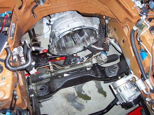

Originally Posted by ht4
You do not need to disconnect the compressor to pull the engine... Just unbolt it from the block and leave it to the side... no need to discharge. That will save you some time and $$.
ya the compressor is just bolted to the side of the block. i just left mine hanging in the engine compartment when i pulled the motor. power steering pump too. save some money for not having to recharge the system.
Originally Posted by 350zDCalb
please explain in more detail, i didnt know this...
The attached pic is from this thread: https://my350z.com/forum/engine-drivetrain-and-forced-induction-diy/111571-how-to-swap-your-own-built-engine-by-bruschijr-updated-6-17-2005-a.html
Look at posts 7-20 in this thread...
EDIT- LOL, you even posted to this thread! (post #26)
