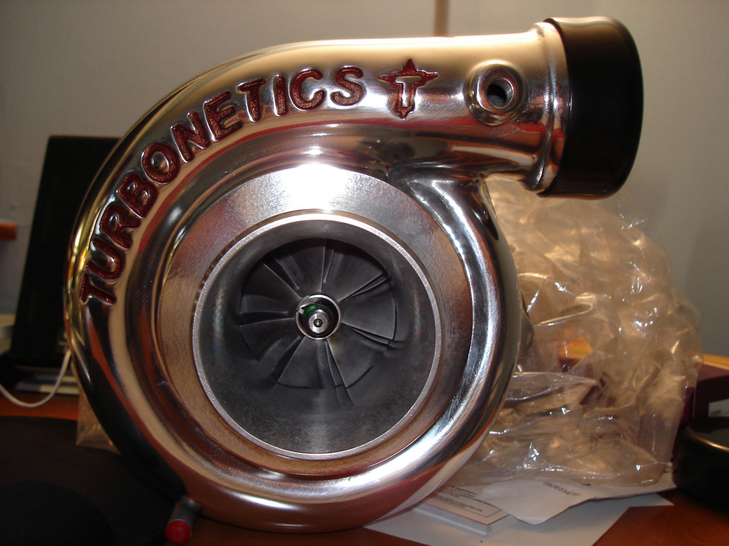

By the way, did your turbo come with the Turbonetics logo in red like that? Mine didn't.

The red Turbonetics logo was not like that when I got it. I saw the picture of the turbo in the Turbonetics advertisement in the forum and just took red permanent marker and filled it in. I will post an up-close picture of it.
You might be right. I've heard from most that the kit runs around 8.5psi on the stock exhaust. I guess the difference between 8 and 8.5psi is just a small difference in springs, so it doesn't matter too much.
Nice mod on the turbo though. I was thinking about painting something in there with some high-temp paint but it would be really hard with it already on the car.

Upclose picture of turbo.
