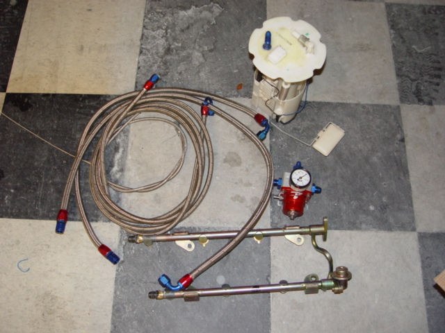

Heres a pic

hmmm. not really the best way of doing it. what hp you trying to get? there are restrictors in the stock fuel rails that need to be drilled out, and from the looks of it only one fuel rail is being fed and relying on the crossover tube to feed the other. if the rear of the rails were cut off and welded on fittings, then both rails could be fed and the fronts used for the return to the fpr, then return to the tank. only going by what i can tell in the pics though.

Its a hell of a clean job! Im only looking for 400hp. Just trying to make things safe on a stock block.

looking at the amount of line you have, they must be using the stock fuel lines to connect to the rails. at 400whp you should still be ok. but look down the rear of the rails. you will see it restricts to about 1/2 the diameter. better fuel flow can be had by drilling this out. prolly won't hinder at 400whp, but what the hell.

Hmm there is a TON of line. Im pretty sure it runs ALL the way back. But yeah its the wifes car so I dont want anything above 400hp,lol.

ya looks like the long one is going to be the return. but there is still the stock fuel feed line fitting on the output of the fuel pump housing, so i'm guessing they were using the stock fuel rail feed for the rails too. should still work for that hp range though. but much more, and some changes would be in order. simple things though. good luck. you got a smoking deal on that car so you will be miles ahead in the long run.
