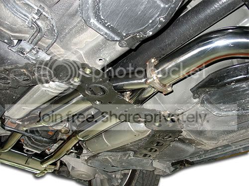

The ST exhaust is a split single exhaust. When you have a ST, you only have one exhaust feed. The only feed is off the one turbo. The APS single turbo exhaust splits that single feed into duals.
Pics:
Split point looking towards the back of the car:
a full exhaust shot:
