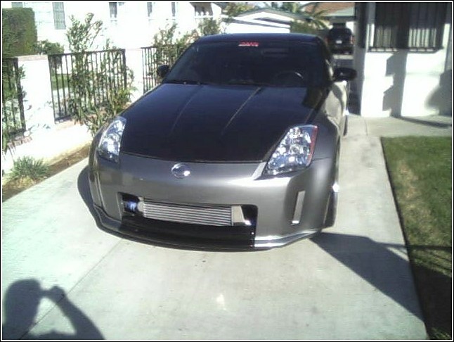

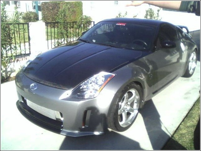

My camera broke but here is a taste:
Attached Thumbnails Turbo Install DONE plus other goodies! I need help on a few things though!-2.jpg   Turbo Install DONE plus other goodies! I need help on a few things though!-3.jpg   Turbo Install DONE plus other goodies! I need help on a few things though!-4.jpg
