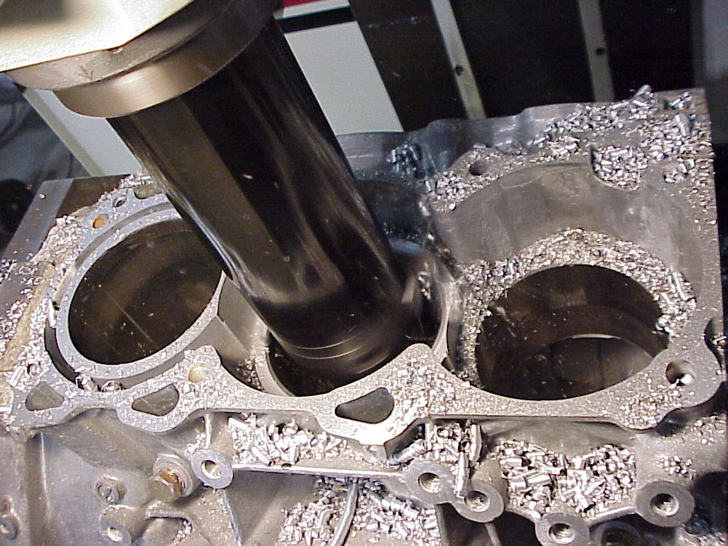

As a teaser, here is a picture of GTM's CNC machine cutting down a block for sleeve installation.
Attached Thumbnails shortblock at the machine shop, overbore? what hardware?-mvc-182x.jpg
