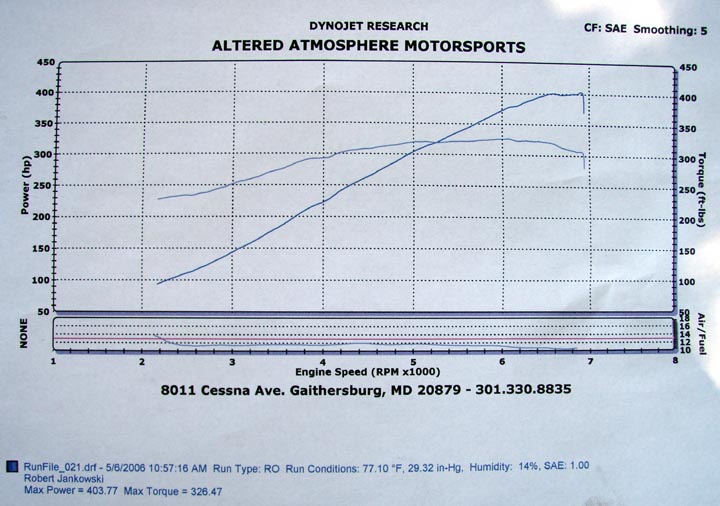

Well finally after a year I found some time to get my Z tuned. The guys at AAM were great, and lots of help, answer all my questions and even gave us some good places to go out at night. Thanks AAM. The car feels much better now. The speeding ticket I got on the way home says it all LOL. Here is the dyno chart.

Is it me, or does the dyno chart look RICH at the top end???
Looks like it touches a/f of 10 around 6600rpm.
The dyno is a little rich......The reason Mike tuned it like that is because I live 8 hours north of there shop. When I got home, my AFR gauge shows that it leaned out a little. I'm going to data log the AFR with my Zeitronix and see what it looks like
