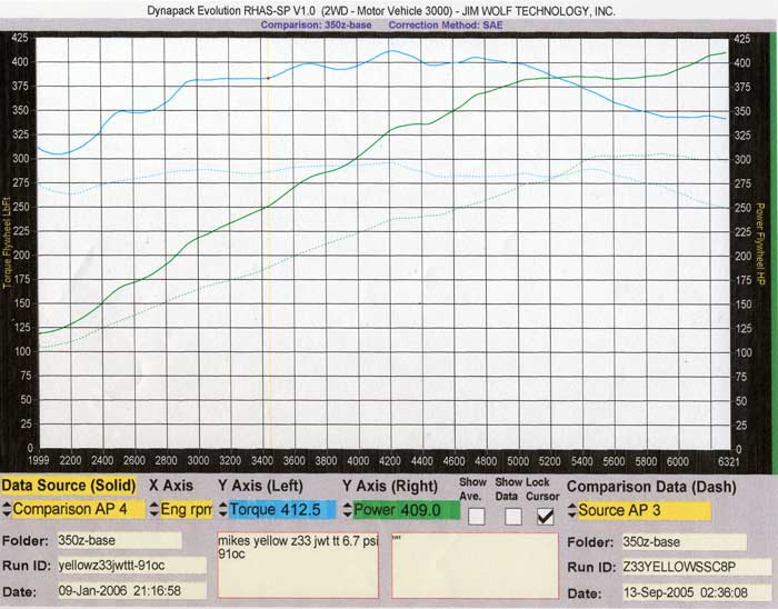

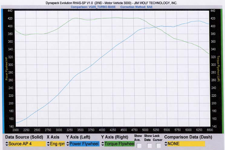

Here is some random charts of some of our JWT TT (530BB) dyno runs. Most of these dyno charts have been posted one time or another, but here they are again, hope they help.
Attached Thumbnails Question for the JWT TT guys.....-350ztt_413hp.jpg   Question for the JWT TT guys.....-mikedyno.jpg

Thanks for the dyno sheets. Perhaps my search skills are not leet enough at this point. It appears the stock motor cars make great numbers to redline. Do you have any of the built car dynos that run out to 7000rpms? or higher? Since searching owns me and you have these all somewhere, I can wait for you. It appears double posting owns you.

Scott, thanks again for posting those charts, I know I had seen them before, but couldn't find them to answer some of the doubters.
The second stock dyno with 320 ft-lbs of torque at 2000 rpms is impressive enough, but how did that other one get 400 at 2000 rpm, it's within 20 ft-lbs of the max. That's amazing! Any difference in other mods?
