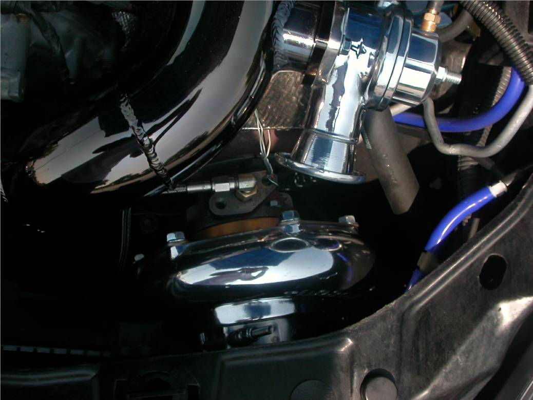

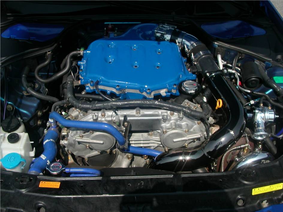

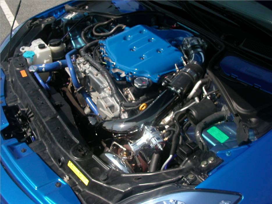

Default Here are some pics.
Here you go
Attached Thumbnails Turbonetics  Numbers-copy-of-dscn1178.jpg   Turbonetics  Numbers-copy-of-dscn1180.jpg   Turbonetics  Numbers-copy-of-dscn1181.jpg
