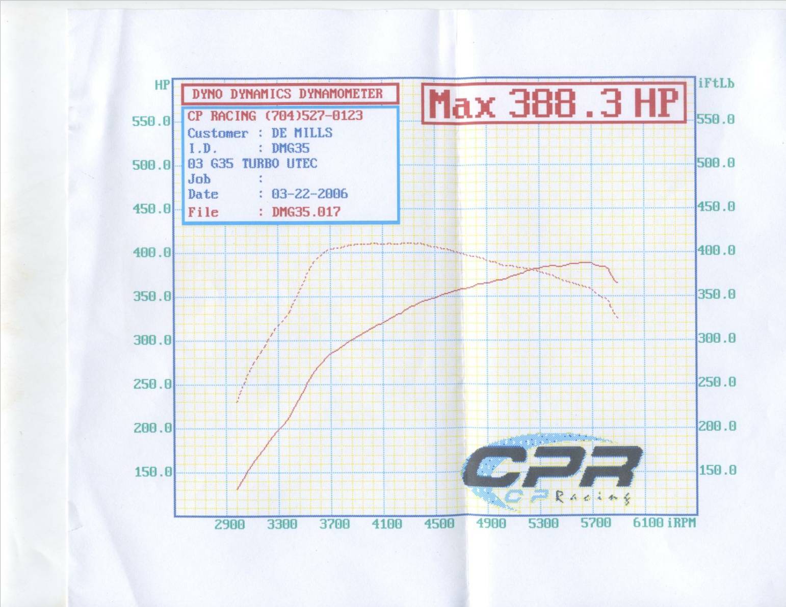

Here you go

Why did they only run the dyno out to 5900rpm??
Because as you can see anything after that i really start to lose power and Tq.
When we tuned De's car, the RPM pickup unit was not working correctly. So we had to generate RPM and tune the car via road speed. As a result, there tends to be a variance between actual RPM, and the RPM listed on the graph. I can assure you we ran his engine all the way to redline....many times.
I too was surprised with the stock exhuast system. But as we tried to raise boost further, no additional peak power was generated. We told De he had to get an exhuast before we raised the boost.
