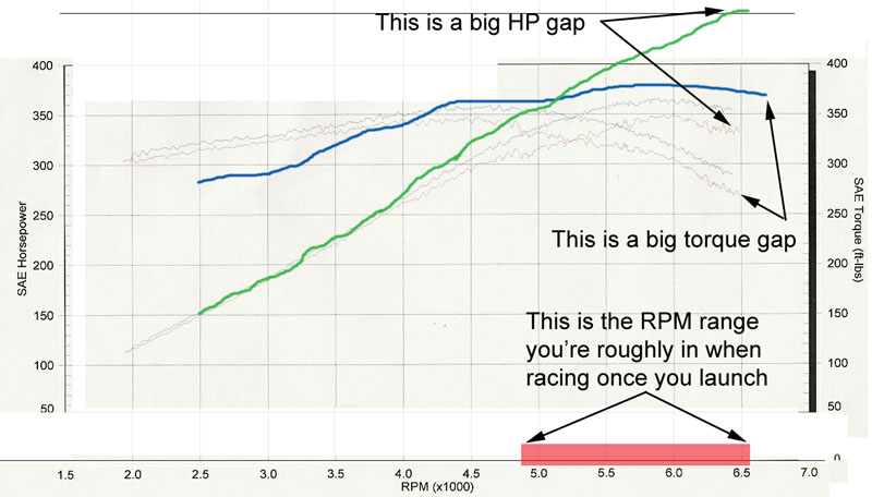

here's a dynojet graph of a C6 (and a C6 with an exhaust for the higher curve) - a manual of course. And here's what a 450whp vortech would look like if it was overlayed over it. This is just for the sake of comparison. If anyone doubts it's a real vortech curve, look up 450whp vortech dynos and compare it - same general thing
the green line is vortech HP, blue is TQ.
I know dynos are not 100% comparable, but this is a ballpark comparison anyway
the graph speaks for itself, not much else for me to say. The C6's tq drops way off up high, while the vortech's is still strong because it's getting more and more boost as it gets higher.
