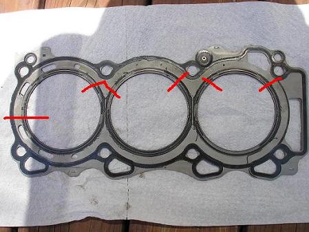

Default pic of gasket
took a pic of the gasket , just to let you see where it was leaking .
