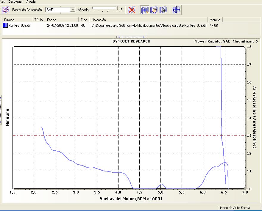

I have problems adding fuel in the 6000+ rpm range , does anyone had have the same problem with more than 450 rwhp ?
I have the stock aps fuel system , what will be the most restrictive part of the system.

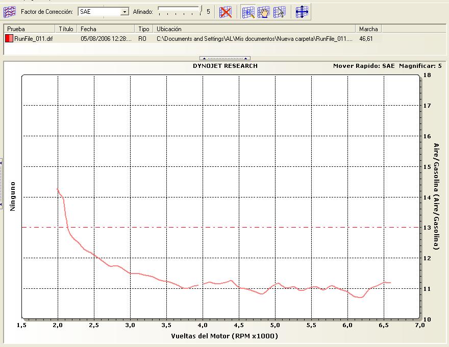

I donīt have a UTEC , I have the unichip.To control my AFRs I have installed an Apexi SAFC2 , between the unichip and the ECU. I donīt have any chance to get an aps dealer here.
If you see my after and before charts , you can see the SAFC2 working great, but the problem is in the top end power, I canīt add more fuel in this range, and with cold temps my boost is raised to 11 psi and my wideband shows around 12-12.2 ,I think this is a fuel amount related problem.

I have the SAFC2 installed "between" the unichip and the ECU, off course I donīt have timimg control , but with the stock map for 91 octane and a CR around 9.3:1.....would be Ok.I have a turboXS Knocklite to check any knock event.

You have a piggy back controlling a piggy back controlling the OE ecu. That is not a good combination. The problem you are encountering is that the SAFC2 can only add/subtract up to 50% signal modification. So, in effect, you can only modify the modified signal. Your range of signal modification is decreased.
Remove the SAFC2 and tune it with the UNICHIP only. Your problem should go away. I'm assuming the only reason your using an SAFC is because no one in your area tunes UNICHIP.
BTW, you do have timing control. It's in the UNICHIP.
You are definitely at the end of those fuel injectors as well.
