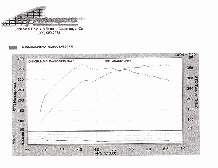

Big thanks to SAM at GT MOTORSPORTS.
Sam tried everything imaginable to try to figure out what the problem was. Then, checked everything again. I was getting impatient and was ready to just buy a totally different turbo. Sam suspected that it was a turbo issue however he wanted to be sure. Sam took off my turbo to see if it was in fact a turbo issue. When he took the turbo off he found the problem. The problem was that the silicone coupling that connects to the intake side of the turbo was in terrible shape. It was basically collapsing at high rpms. Turns out it was a simple fix.
I am now holding steady boost to redline. My numbers are 374.7whp and 370.5tq i beleive it was at 8.5psi (please correct me if i am wrong)
Stay tuned. more to come.
