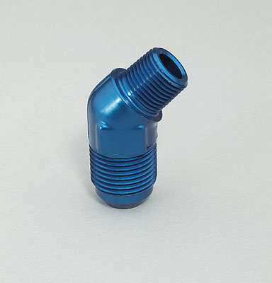

I have come across a few parts that Turbonetics owners might find come in handy.
3/8 NPT plug to cap off the oil return hole in the upper oil pan to put in an oil pan spacer return or to block it off when removing the kit. Sumitt part# SUM-G1487B-1
You can use this -10AN 3/8 NPT 45 degree swivel for an upper pan oil return fitting. Sumitt part# EAR-824511ERL Get some 10AN oil safe heat resistant braided line to use as an oil return line.
Use this 3/8 -10AN fitting for the turbo oil return fitting. Sumitt part# EAR-982311ERL

if that last fitting is aluminum, I'd be wary of using it in on the turbo itself....I like using brass fittings there or steel due to the heat that cast iron gets.

Werd...the turbo oil drain fitting should be brass. I wouldn't use aluminum there either...

17,000 mi and no issues withe the aluminum elbow. AAM uses this part on all of there Turbonetics oil spacer kits.
