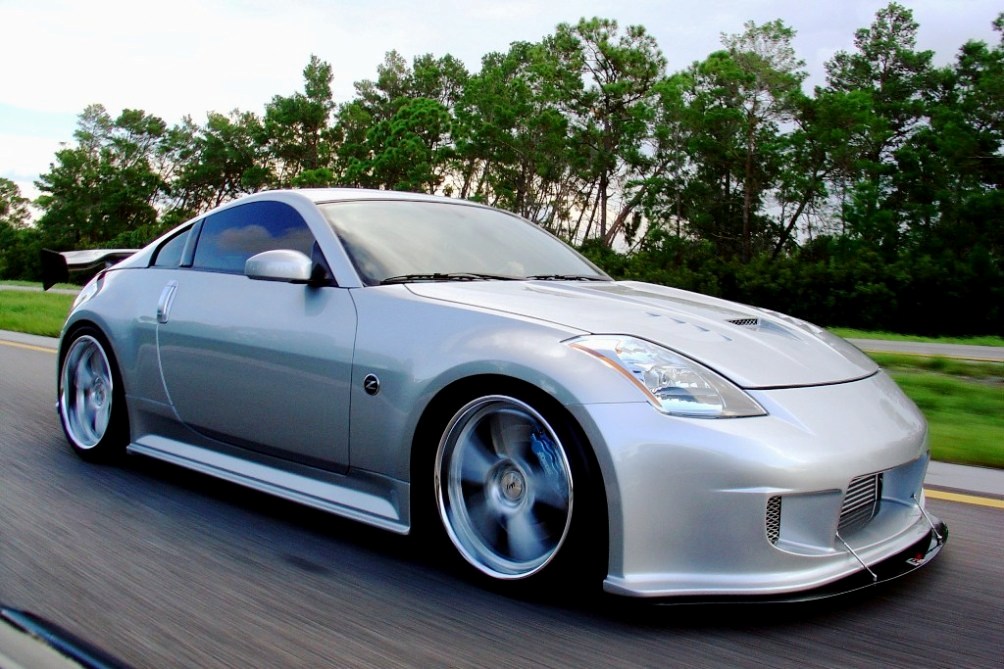

Thanks George and all of GTM; great work. I was only going 129mph in this picture. j/k
