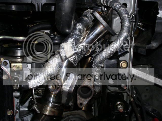

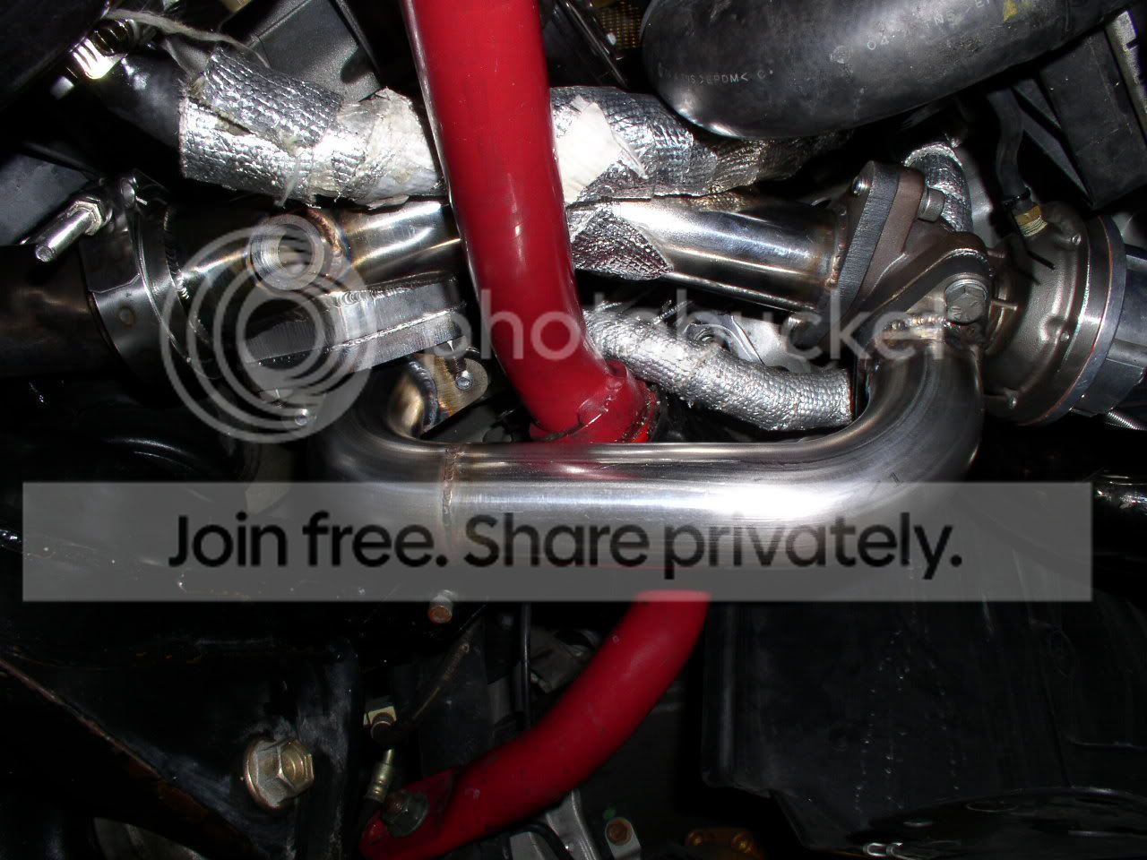

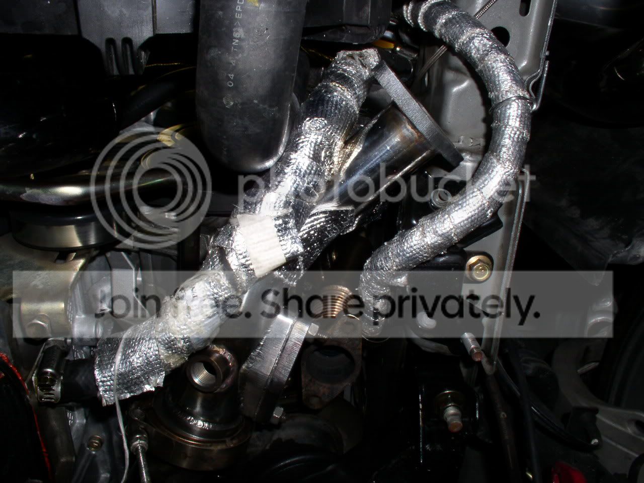

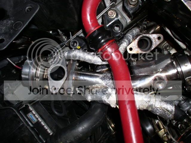

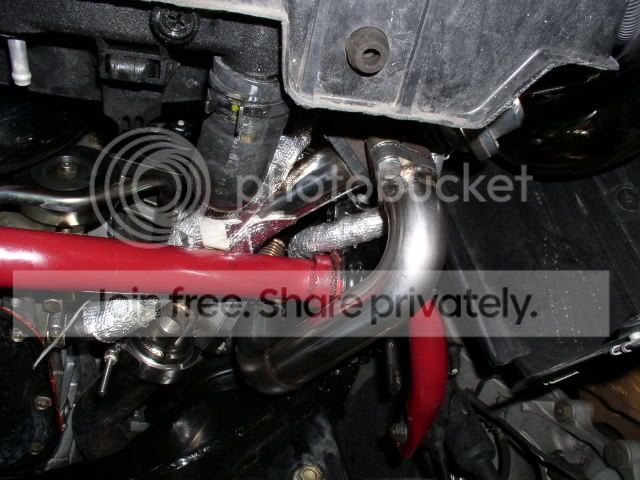

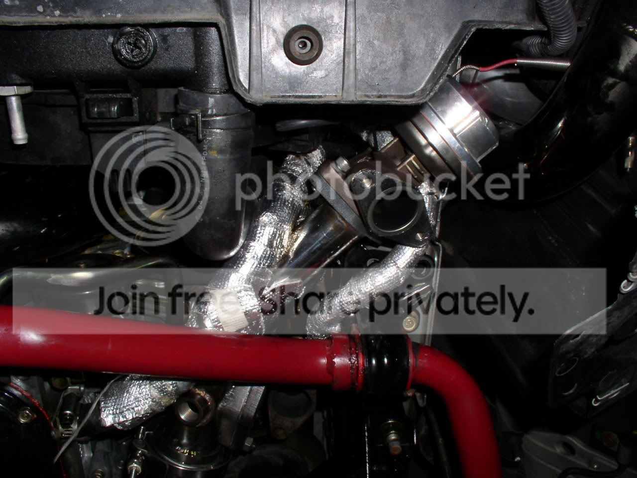

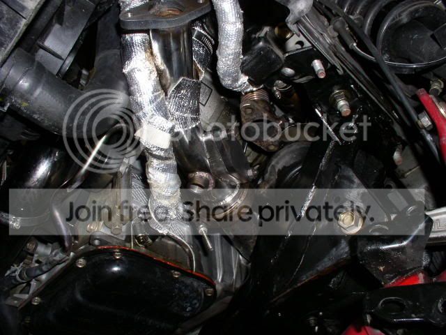

I'm going to be installing this kit next month. I already have the kit and been going threw the instructions pretty well and have all ready started on somethings. But they don't show anything about the overboost pipe setup.
I like to have pics of the overboost pipe to see how it is setup. I have a good idea of what's post to happen. Just want to have a pic. No rush though. But also not sure what you do with the pipe that has a bellowed end, since your moving the wastegate.

Here you go:

Man, thanks. That was fast.

Cool, I was kinda wondering what it looked like.

So is this thing called an "overboost pipe" or a "wastegate relocation pipe"? I always referred to it as the latter.
Old Jan 2, 2007 | 03:27 PM
MIAPLAYA's Avatar
MIAPLAYA
Posts: 11,373
From: Escondido
Same thing I guess. It is a wastegate relocation pipe and an overboost correction pipe as well.

whos car is that on the pics?
Old Jan 2, 2007 | 08:43 PM
MIAPLAYA's Avatar
MIAPLAYA
Posts: 11,373
From: Escondido
RedHotZ

I'm finally getting around to doing my installation and I wanted to check these pics again to see if my setup is the same. I'm having a problem with the bolts TN supplies for the wastegate. Looks like yours are hexkey and the new location is threaded so they thread into that with a lockwasher. I got 8mm bolts with washers, lockwashers, and nuts. The bolts are too short. I can't get the nut started with all of the hardware. With only the lockwasher I can almost get the bolt flush with the outside of the nut when it's tightened down.
Anyone else have this problem? I don't think I want to keep it like this. I guess I'll have to get some longer bolts.
Old Jan 24, 2007 | 09:05 AM
Three5oZee's Avatar
Three5oZee
Posts: 209
From: Palm Beach County, FL
I think I had the same problem when I installed my kit. Just run to a hardware store an get some bolts that are long enough and can withstand that heat/ pressure.
