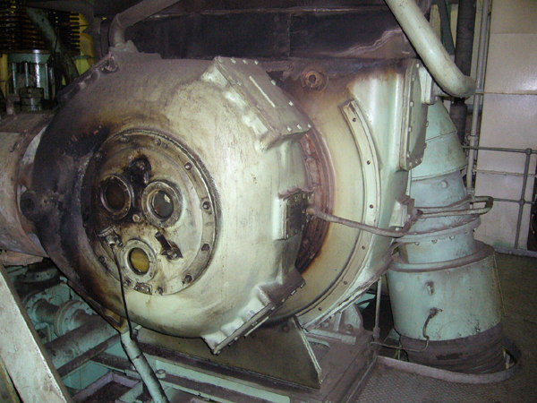

turbo turbines are sized to engine. Soooo...can you really say how the turbo will spool?
I certainly can't.
This turbo on a 18,000 hp slow speed diesel has an appropriately sized turbine.

Not true. These STS kit turbochargers have typically been undersized in the past to avoid excess lag. I seem to remember something about a 16g on a 6.0L LS2?
